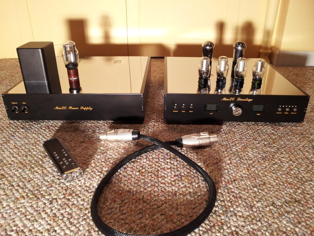

I'm with Andy on this one. I've bought, built and modified preamps using the 6SN7, 2C22 and 26 tubes, and the 26 I built is the one that's staying in my system. It just sounds better to me.
By better I don't mean syrupy and distorted, I mean clearer, cleaner and at the same time appropriately warm. It did take me a whole lot of work to get there, though, with mass loaded and rubber mounted sockets on a separate subchassis to deal with microphonics, separate power supply with choke input HT and filament supplies (with Coleman reg boards) to eliminate hum, cascoded CCS plate loading, battery grid bias through an LL1676 input transformer, 80% nickel autoformer outputs/volume controls, etc. but I just love how it sounds.
And having a sound that pleases you is the name of this game, right?
And yes, I do display it as a piece of audio jewelry as well...shoot me for my indiscretions ...Check it out:
Could it be that all the attention to detail in the surrounding circuitry which may be required for a DHT is part of the explanation? DHTs may need this, while 'lesser' valves can manage reasonably well without it so don't get it.
I'm sure that is part of the explanation. My first breadboard 26 hummed audibly and made a clunking noise every time I turned the attenuator due to microphonics. It took a lot of time and effort to get it right, but now it is dead quiet (quieter than my 6SN7 preamp) while being extremely musical.
I wouldn't call IDHTs "lesser". I do however believe from my experience that IF you want to spend the considerable effort, time and money on the surrounding circuitry and chassis, that the 26 sounds better than the 6SN7 or the 2C22 in a preamp.
