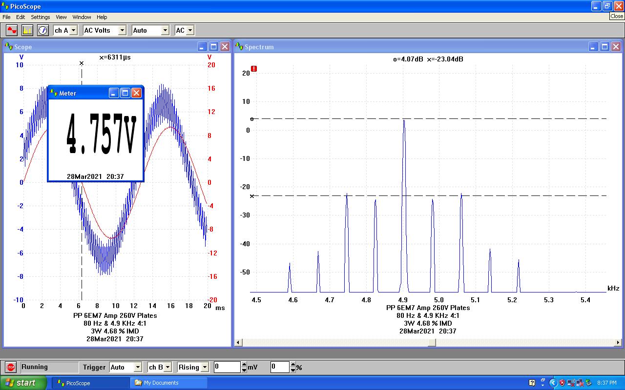

2H in the output of a PP Amp near max power? Somethings Wrong!👎

The IMD by the SMPTE method at 3W got left out in the results post.

no , 3rd only, and before it saturates, I don't know what you are trying to get at? I don't have a computer version of the schematic and not going to do one. It is a simple floating grid bias input and concertina, it is balanced, 6bl7, the voltage is quite low, bias around 45 ma cant remember, I learned a lot about various versions on the tube, some can't stand bias, some are very resistant. Their internal components are different.
All I can say is that it is not an accurate amp , or a distortion machine, but it has a lush pleasing sound, perfect for small room.
fyi = 18 watts , I guess at 10% , I have similar results, around 14 watts mine is clipping

14-15W out of a single 6BX7 is pure class B but requires rather high plate voltage if it were possible, I guess. Close to the 500V limit. Even from parallel PP, 14-15W it's closer to class B than A.
18 watt around 1 % thd is possible with 4 tubes , the question is it worth it when you can have lower cost amps with other types of tubes, what is great of the 6bx7 is low plate impedance etc.
It's not worth it. With 4xPCL82 per channel you make the entire amplifier with ample choice of circuit, having 4 signal triodes as well. The PCL82 triode-strapped pentode is just as linear as the 6BX7 and run at 280V/25mA has about 1.6-1.7K plate resistance. The output power is up to 10W, with 4-5K OPT.
