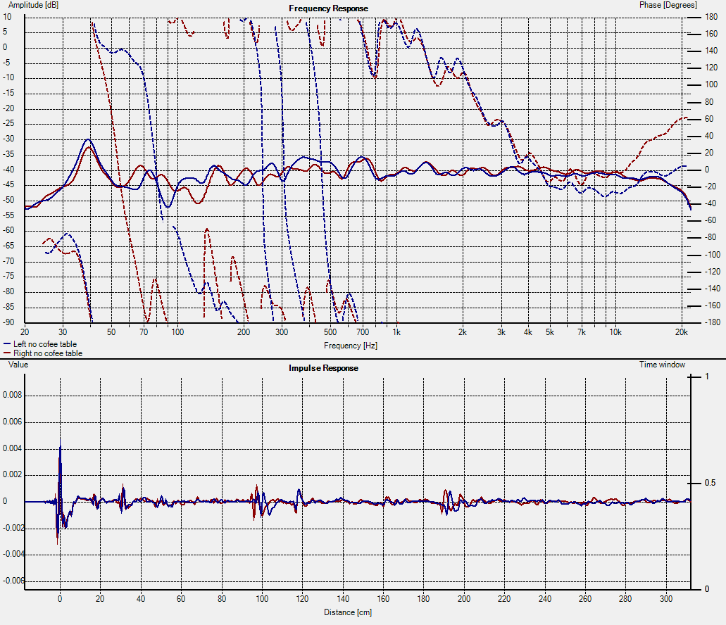

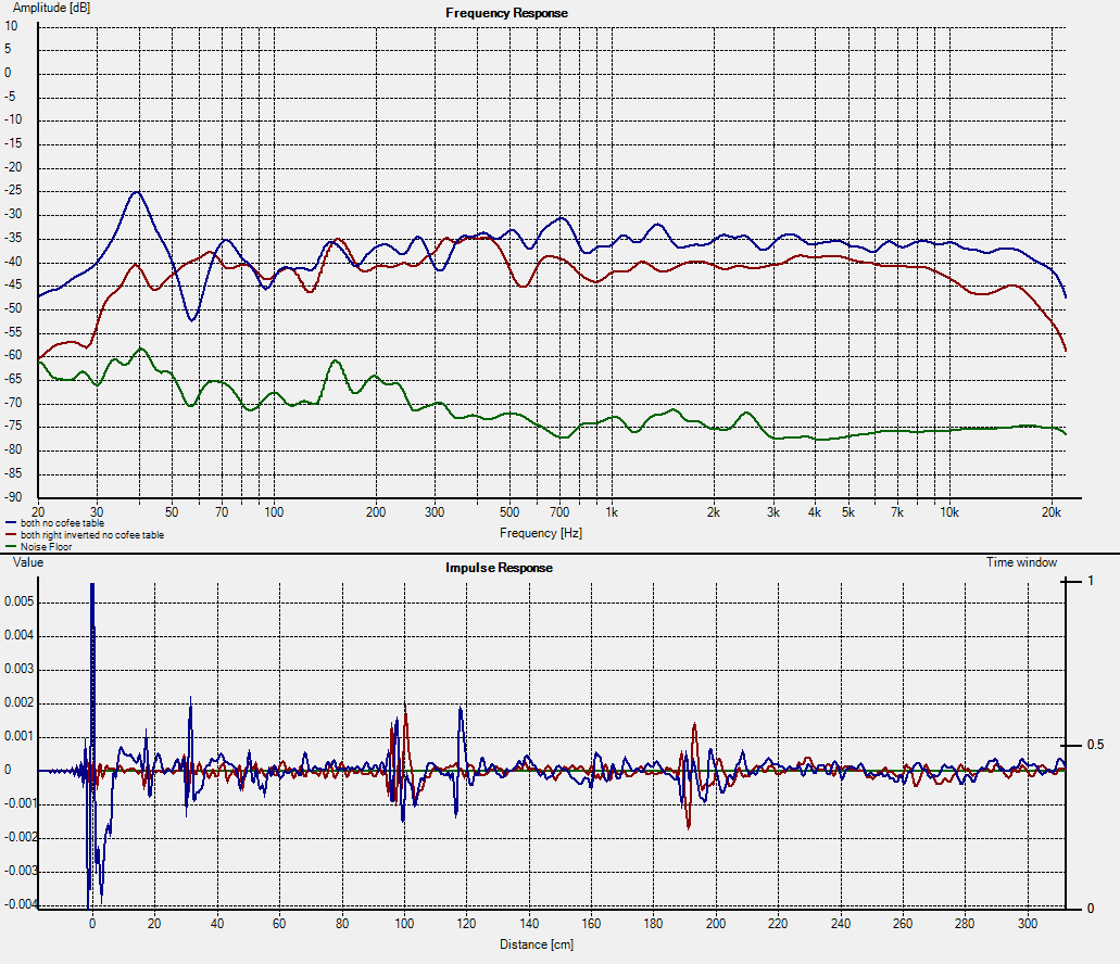

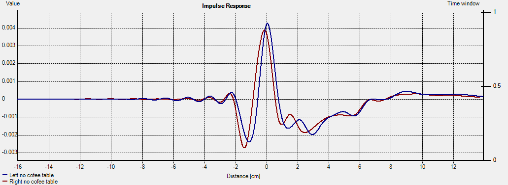

So I decided to do some more measurements tonight. I think that they pretty clearly show the asymetry of my room. This time I used swept sine with holm impulse. very similar to the results with pink noise in REW.
I think that the second graph showing the left and right is quite telling, you can very clearly see the different reflection times in the impulse response.
I had the mic within a few milimeters of dead centre based on the impusle (third pic).
The left is the speaker that is close to the wall The phase at frequencies below 500Hz is all over the place, no wonder I loose the correlation below that frequency!
