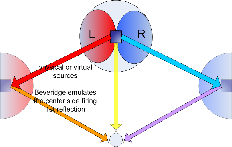

Now this journey has got me to the crossroads: Stereolith vs. Beveridge on wall line array ?
Beveridge was the inspiration of the placement.
The purpose of such an array, as I said, is to mimic the stereolithic side wall reflections with real sound sources.
Place the Beveridge at the point of first ipsilateral reflection from a Stereolith. Of course it is not identical, but the pattern is the same, only that Stereolith creates wider stage than Beveridge.

but how can exactly such an array achieve the ideal directivity pattern of directional <1 kHz, stereolitic >1 kHz?
pps. I mean of both directional <1 kHz, stereolitic >1 kHz, and in particular the directional <1 kHz part of it?
ps.
Let's make the beveridge as a sparse floor-ceiling line array and it mimics the side wall reflections of a stereolithic projection.
😀 Markus, now you take pen and paper and draw some lines, maybe with the help of a ruler![]()
Here's the direct sound and first side wall reflections for Beveridge:
... and Stereolith:
Fundamentally different.
And fundamentally, like, where's the speakers?
Where the arrows emanate from. Green is the direct sound. Blue is the first side wall reflection for the left speaker, green for the right speaker.
markus, I respect and envy somehow your strictness (true, it's the only way to go), but I suppose that Elias was thinking of the beveridge taking the exact place of the virtual speaker created by a side firing, without considering immediately their own reflection paths.
When listening a side firing in a reflective room, don't have to draw something so much it's the evidence.

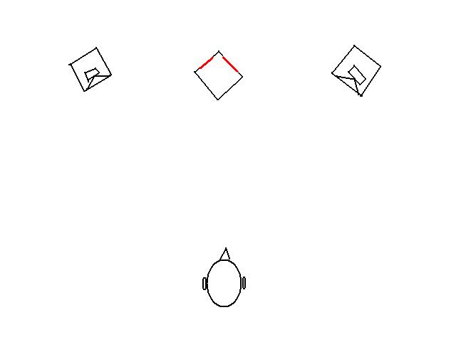

What about such a setup, where you would try to avoid the problem with treble localization and work conventional in the less critical region?
![appl[1].gif](https://www.yesfans.com/images/smilies/appl[1].gif)
and how about making the center midtweeter channel >1 kHz just mono - just like Schupbach does? ...more directional or less? perhaps back-firing?
this plus OB-arrays <1 kHz more like Beveridge that is closer to side walls for wider angles than conventional 30º?
Sorry but I don't understand what you're trying to say.
