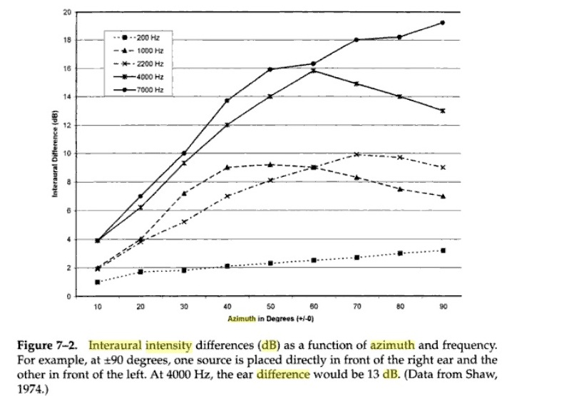

at high frequencies our head dramatically reduces channel crosstalk above ~1-2Khz for speaker separations of ~60 degrees and greater.
Are You sure? I would say that a 7 dB for 60 degrees (+/- 30 degrees) is not dramatic enough
