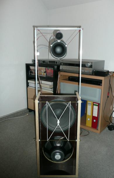

I listen to a dipole which is toed in 45 degrees in a somewhat Geddes-like setup, with the rear wave reflected and delayed via multiple walls to the listener and the nulls towards the side walls (see attachment).
I've experimented a lot with the toe-in. I prefer this setup, but I find the difference with a 0 deg setup not very large. You do lose some image width with the 45 deg setup, but I think it sounds a little more spacious and enveloping. They're several meters from the rear wall by the way.

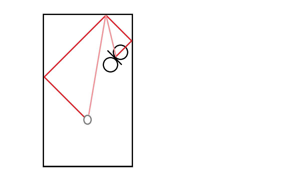

It's somewhat hard to get there with a dipole but my idea was to create a second order reflection, first hitting the front wall and then the ipsilateral wall.

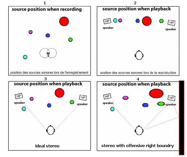

I will utilize the figure used earlier to make some points of my own. Since there's some ambiguity over what stereo is supposed to portray I'd like to check my understanding against others.
The relative distance to 2 microphones should not only give cues on the left-right axis but also depth. We can certainly discern at what distance a sound originated, this should be true when listening to a phantom image as well. It must be noted that the left-right and depth information are not absolute, so the original position of the sources can never be restored. An ideal stereo image should spread out the sources to their relative positions in a similar manner as illustrated in Figure3.
In a realistic environment the stereo image becomes smeared as shown in Figure4 or collapses completely. There is also some disagreement over whether the stereo image forms in front of the speakers or behind but I suspect that might be influenced by the front wall.

Except two conventional microphones or a stereo microphone do not work the same way as two ears.The relative distance to 2 microphones should not only give cues on the left-right axis but also depth. We can certainly discern at what distance a sound originated, this should be true when listening to a phantom image as well.
Although time delay between the ears plays a part in identifying the azimuth of a sound source this effect only occurs below about 800Hz, and for higher frequency components its done by the HRTF,. Since normal microphones have no human-like HRTF a large percentage of the possible image localization cues are lost right from the start when recording in this fashion.
This is before you even consider corruption in the playback system - for example reflections from walls.

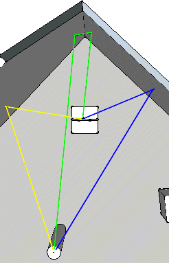

Is this, what you are looking for? Very week first ipsilateral reflection (yellow), strong second ipsilateral reflection (green), week frontwall reflection (blue). Pole is listening position.I believe that some reflections have to form a certain relationship when the classic stereo triangel is used. The contralateral reflection being above a certain level will result in a very narrow stage. Ipsilateral reflections can produce a very wide stage. The higher the level, the wider the stage.
No, I would want yellow the strongest, blue and green nonexistent.
Don't know if it would work well (I don't think it would), but this is probably achieved easiest with high frontal only directivity, and with the speaker toed out. The degree of toe-out could be chosen such that you get any desired ratio of direct to ipsilateral reflected sound. Have you tried it with your Geddes speakers?
