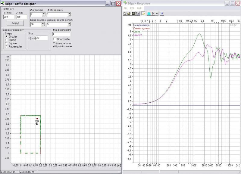

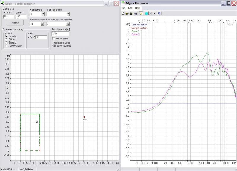

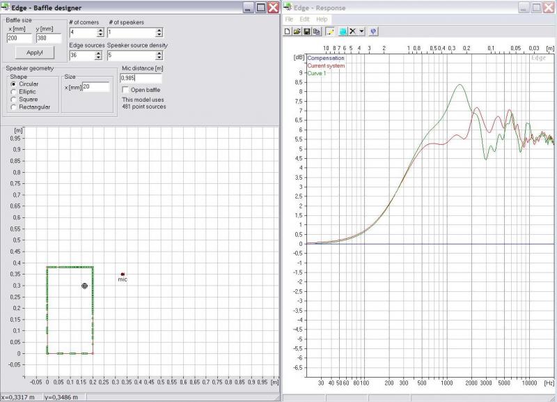

Example comparison of effects from
listening angle vs. symmetric/asymmetric mounting of tweeter on baffle
Symmetric Tweeter (no baffle roundoffs)
- 00-Degrees: Ripple (2Khz ... 10Khz) ca. 3,8dB
- 10-Degrees: Ripple (2Khz ... 10Khz) ca. 2,5dB
- 30-Degrees: Ripple (2Khz ... 10Khz) ca. 3,0dB
Asymmetric Tweeter (no baffle roundoffs)
- 00-Degrees: Ripple (2Khz ... 10Khz) ca. 2,8 dB
- 10-Degrees: Ripple (2Khz ... 10Khz) ca. 2,1 dB
- 30-Degrees: Ripple (2Khz ... 10Khz) ca. 1,5 dB
Pictures refer to listening angles 00-, 10-, 30- degrees
Green : Symmetric tweeter mounting position (same height but equal distance to left and right baffle edge)
Pink : Asymmetric tweeter mounting position
Simularion angles changed towards the shorter distance between tweeter an baffle:
Asymmetric tweeter is shifted prefereably "inside" the stereo base to reduce diffraction ripple.
Kind Regards

Not sure if the conclusion is valid because ripple is the same for each speaker.
Let's think about it ...
during shifting the (listening) position, the off axis angle
increases for the farther speaker and decreases for the
closer speaker (assuming speakers are not toed in).
You are right in that we would have to compare differences
in the L-R frequency response for a given setup including
both speakers, toe-in angle etc.
But effects will tend to get even worse IMO for a shift in listening
position: There is no reason for mitigation.
For a perfect symmetrical setup and listening position - you are right -
the diffraction effects should be symmetrical (the same) for both channels.
But such kind of diffraction effects will make imageing noteably
instable due to small listener's offsets i suppose .... and that's what
Simon was suggesting.
But diffraction won't cause the same frequency response deviation from both speakers for a number of reasons, some of which you both missed.
1) If you cross the speakers in front of or behind the listener - as is almost always the case for good imaging - the angle offset of the listener from the front face of the speakers is not symmetrical for left and right as the listener moves along a horizontal/sideways axis.
For example if the speakers are crossed in front of the listener such that the speakers are both 10 degrees off pointing at the listener, as you move the listener sideways to the left you are going further off axis on the left speaker but moving closer towards on axis for the right speaker - but past some point you will start going off axis again on the other side of the right speaker.
Clearly if the off axis angle from each speaker is different (and moving in the same direction for some listener positional ranges and the opposite direction for others) the diffraction ripple of the two speakers will not track at all.
2) Even if the speakers are toed exactly at the listener (which would only be valid for one listening distance) unless the speakers are at infinity geometry means the angles will not be equal and opposite as the listener moves sideway any significant distance. (Simple trig will bear this out)
3) If the speakers are of a asymmetric design, (tweeter offset to the right on the left speaker and the left on the right speaker for example) then all thoughts of symmetry when going off axis are thrown out the window - as the listener moves to the left they go off the "wide side" of the left speaker but the "narrow side" of the right speaker - the diffraction response will not match at all!
Its this last point which is one of the reasons why I do NOT like asymmetric speaker designs. (mirror image left and right instead of mirrored down the centreline of the speaker)
An asymmetrical design might result in a flatter on axis response but the changes off axis each way will be quite different such that phantom image stability is further harmed. The right way to do it IMHO is to have each speaker symmetrical down its centre line (left and right speakers identical) and deal with treble diffraction using directivity and/or absorption.
This has the best change of minimising differences in left/right treble response as you move sideways thus optimising the phantom image stability and centring.
That's what I was suggesting, although to my way of thinking the traditional approaches to minimising diffraction effects like offset drivers actually harm the stability of the phantom image for the reason described above.
Lateral image placement at high frequencies (> ~2khz) is almost entirely left/right amplitude balance. It takes a relatively small imbalance in the treble over an octave or more (on the order of 1dB) to skew the phantom image significantly to one side.
I first realised this when trying to use two full range drivers which due to differences in their cone condition weren't well matched in the treble - the overall balance and trend was similar but all the individual ups and downs and bumps were different and distributed at different frequencies so that at any given frequency in the treble one driver or the other might be a couple of dB or so higher or lower than the other.
This resulted in a lot of "tearing" of the phantom image where it would seem to pull to one side or the other depending on content and sometimes "smear" into a wider but less distinct phantom image. I spent a lot of time applying unique left/right EQ to match the two drivers as much as possible and got a good feel for just how critical it was.
With the two channels more closely matching in frequency response the phantom image was much more stable and pin point in the centre without side to side tearing, but I had to match the two drivers with EQ very closely to achieve it. The match between left and right was a lot more critical than adherence to a flat response as far as the phantom image was concerned.
Now imagine the effects of diffraction at treble frequencies - at any given frequency as you move further off axis the diffraction ripple will cause the response to alternatively increase and decrease as in a ripple. At a different frequency the opposite may be happening at the same angle, as each frequency will have its own ripple density.
What happens is as the listener moves sideways certain key frequency bands (not all frequencies are equal in the treble in their effect on imaging) will increase on one speaker and simultaneously decrease on the other speaker, pulling the image to the side.
You can easily get a situation where moving slightly to the left causes an increase in the treble to the right ear and a decrease to the left ear pulling the image to the opposite side than the one that you moved to..but if you keep moving it "flips" back to the other side again as the ripple causes the amplitude balance at key frequency ranges to flip flop between left and right.
It's important to note that two different things can cause very similar symptoms - treble diffraction from the speaker (the speakers actual response directed towards the listener is changing with angle and see-sawing back and forth relative to the opposite speaker as the angle changes) but also stereo cancellation through summation at your ears.
The comb filtering from two different speakers (even diffraction free speakers with near ideal response) will have a similar effect if the separation is not great enough for our HRTF to provide sufficient crosstalk reduction.
So as I said earlier, sufficient angular separation of the speakers is needed to get enough crosstalk reduction in the treble (from your own HRTF) to minimise the effects of comb filtering on the phantom image, but you also need to have a smooth diffraction free horizontal off axis response from the tweeter so that the response either stays the same or smoothly and monotonically falls as you go off axis.
What you don't want is one speaker increasing its response at a given frequency as you move to the side while the other one is simultaneously reducing it, and then reversing roles as you continue to move further to the side - eg I think the response falling monotonically as you move off axis is an important ingredient, something that cannot happen at all frequencies when there is diffraction.
