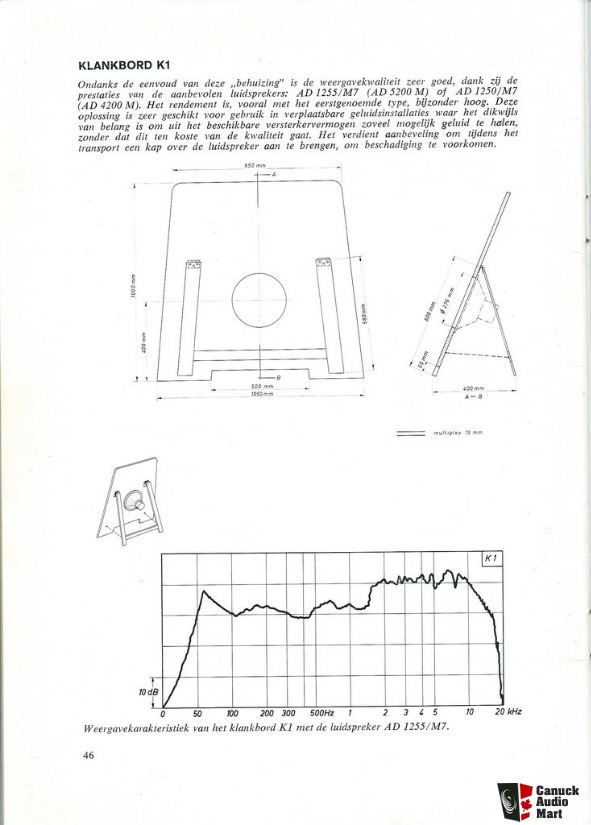

Thank you for your reply. I looked up on google about AD5200 and found a nice piece of article written in another language (Which I cannot understand ). I think it says AD1255/M7 = AD5200M, it is the same thing. I also learned that AD5200M is also called a high fidelity speaker back in their day.
It is great to know about them. I love how they sound, very mellow and laid back... great for old recordings, jazz, and classical music. I am yet to add padding to the enclosures but even without it, it sounds good.

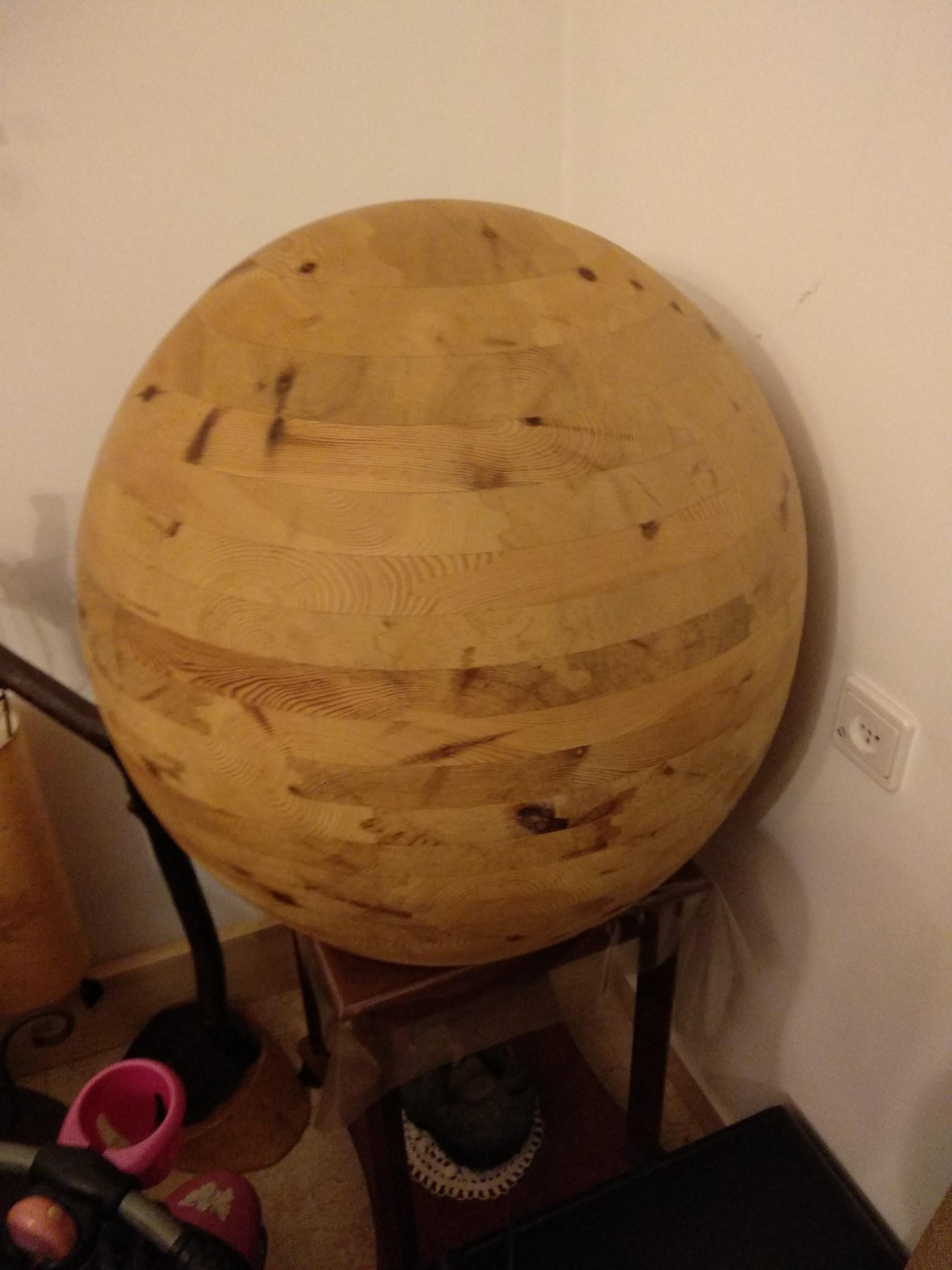

Thanks Dave.I have several possibilities, one of which I have been pondering for 21 years🙂 As yet that sphere thread the diyAudio is not progressing.
Diameter 65cm,weight 32 kg.
Do you have 2 of those?
This is in Dutch. There is a datasheet in English and it says exactly AD1255 / M7 = AD5200. I think the bass depends on the resonance of the room, my room has it about 80hz. And the box is always more predictable. If you find your sound, congratulations and enjoy.
http://www.verheijde.net/library/Philips_1969-01_%20CM3_Radio-Audio-Television_939916106901.pdf

Yes, I have two. OK, thanks. I'll look at the Alpair 10p carefully.
