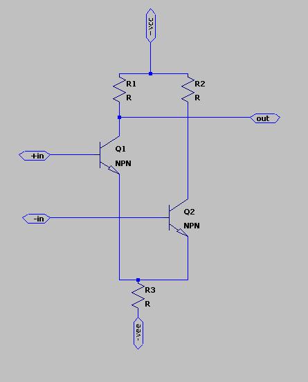

What is sucking in this wiring?
How about that Q2?
Can it be pnp?
Has emitter and collector to be changed?
And how about C4 value?
Thanks!

There is nothing really wrong with that design at all.
"How about that Q2?"
What about it, it's one have of the diff input pair.
"Can it be pnp?"
It must be the same as Q1, it's one half of the diff input pair.
"Has emitter and collector to be changed?"
No, it's one half of the diff input pair.
"And how about C4 value?"
47µF~100µF would be a good value, with R8 and R9 it's part of the bootstrap CCS for Q3.
R2 bootstraps the input impedance (makes it higher).
This is really a common and ordinary amplifier. Use a 10Ω+0.1µF Zobel on the output to ground (before the fuse).

Now I'm wondering Q1. Where comes its collector current?
I draw the schematic so that positive side is upper and it's now easier to understand, but Q1 seems to be quite weird on ordinary differential amp.

DJK you are right, there is nothing wrong with the design, it is just not drawn nicely that is all. The person who drew the schematic forgot to put a ground connection between the 4700uF power supply caps.
that IS the most bizarre way i've seen a diff amp drawn. this looks like something designed for a cheap guitar amp or a console "hi-fi" in the 70's.
btw Q4 in the above schematic is the constant current source for the diff amp. the diodes D4, D5 should be attached to the heat sink for thermal stability.

Any LTP diff pair can be run from asymmetrical rail supplies.
The collector/drain loads are fed from the Full Rail Voltage.
The Tail simply needs a Current. This current can be provided from a variety of voltages of much lesser voltage than Full Rail Voltage.
An infinitely high voltage rail with an infinitely high value resistor makes a good CCS.
McIntosh always used very high voltages for their LTP, their preamps are the same way. The Vas also uses a high value resistor to a high voltage rail.
This is good practice, but most people will not have seen a CCS done this way (or the schematics drawn this way).
