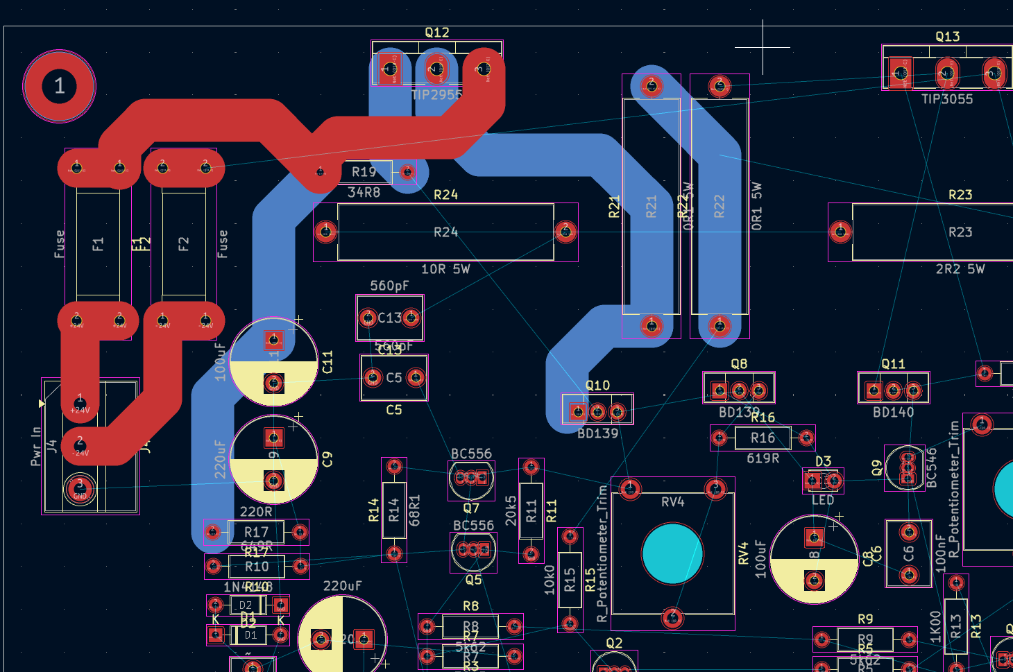

I building a 25W Class A amp using TIP2955 & TIP3055, using KiCad.
powersupply is +/-25.4V
The schematic is done and i now started with the actual PCB.
I now try to fix "netClasses" and atuck with the PWR & OUTPUT net.
When i asked both CoPilot & chatGPT about the trace their answer was:
For a current of 10A, a trace width of approximately 200 mils (5.08 mm) with 1 oz/ft² copper is typically recommended3
.For a current of 15A, you might need a trace width of around 300 mils (7.62 mm) with 1 oz/ft² copper3
Well, sound great, but the space between the pins are less thatn that. How to solve tthat ?
You could use heavier copper. And/or parallel traces on top and bottom, although that would complicate trace routing. Plating the traces with solder would decrease resistance as well.
Place the components to reduce trace lengths so the total resistances and voltage drops are minimized.
You could also use a four layer board so there are separate power and ground layers.

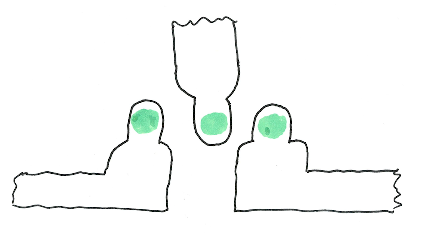

As slender as they need to be, near the footprint's pads. To obey minimum trace to trace spacing rules.
As fat as you want them to be, away from the footprint's pads.

Thanks all.
I got it now.
I've also viewed a couple of KiCad tutorial and figured out netclass as well.
So far i'm working with 2 layers, but 4 layers sound nice, maybe i go there.
One more, maybe stupid but anyway, question.
How long is a "long" trace ? is it more than 5mm or more than 50mm
The board is 120mm x 100mm.
Maybe it's better to make the board 150mm x 120mm and get a bit space between some component for the wider traces?
ex: is it better to have 50mm long and 3mm wide trace than 20mm long and only 1.5mm wide ?
