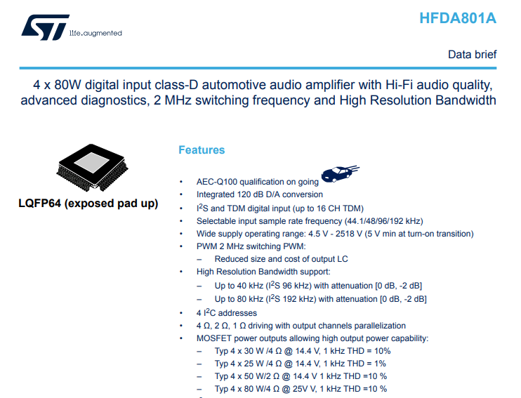

Looks like this one will be better, it has built-in 120dB DAC, 2mHz switching freq and PFFB.

Interesting if it's good and better than TPA3255.Looks like this one will be better, it has built-in 120dB DAC, 2mHz switching freq and PFFB.

I'm curious why do you think this one will be better aside from the DAC? The specs around power output and THD seem pretty mediocre compared to the TAS3251.
