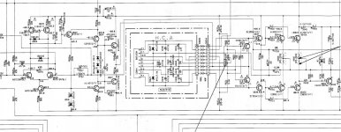

AX-1070 AND the Sony are both "badgers"(blameless)
(below 1-2)
The sony is a "better Badger" with more a refined front end (cascodeed VAS ,
better CCS). It also has a EF2 MOSFET output stage. It would have better
PSSR , as well.
The AX is a proprietary POS with a "super A" type IC trying to make up
for a gradeschool level input stage and a "el cheepo" output stage.
Study the schemas and these conclusions will be apparent.
The sony also has a respectable power supply (as compared to the yamaha).
