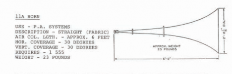

A few years back and "somewhere", maybe the Altec forum, someone posted a nice picture of a 1" CD on a very long horn. Maybe 4 feet long or more. He said that it played down low just fine. From my experience with big horns and also from fiddling around with HornResp, length does seem to be key.

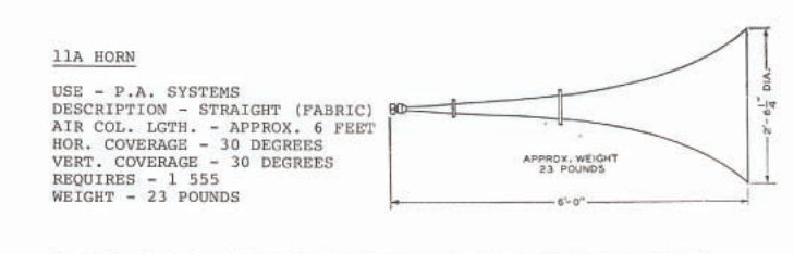

Right, it's a function of throat area, so with a 1" which starts out at > 4 kHz min. it takes a very long, slow expanding horn to go low with 'authority'.
Don't recall, but W.E. had a 6 ft long stage monitor horn for the 555 1" driver. There use to be a picture on line of Judy Garland speaking through one [no driver] doing a vocal test, but can't remember exactly what at this point and no longer have the link 🙁:
