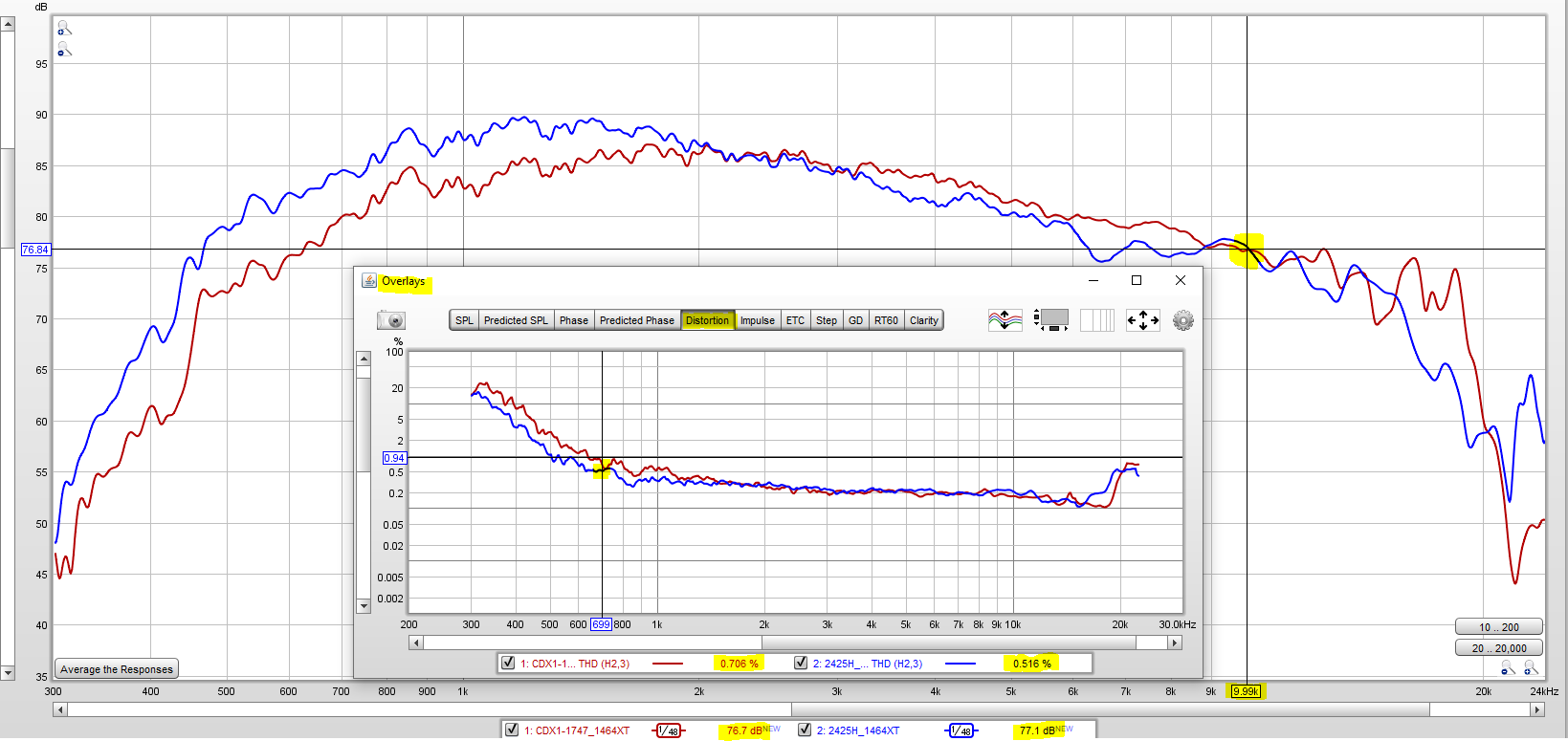

Yes, the XT1464 ( being a longer ) horn extends lower than the 152i clone ( though as I showed above > the limiting factor for achieving lower usable extension will also be any drivers Fs // suspension ).
Anecdotally, I sent an LHF alumnus a pair of my Peerless DFM2535 drivers ( as well as a pair of Celestion CDX1-1747 drivers ) along with the necessary capacitors to allow for "apples to apples" comparisons when mounted to an Altec 811b horn ( & used in the owners mostly stock Altec 846B Valencias ).
He didn't like the Celestions ( at all ) while the smaller Peerless driver acquitted itself very well in a direct comparison to his GPA 902-8a ( that this user had upgraded to from the hapless Altec 806 ).
- He ended up concluding the little Peerless was a worthy upgrade ( especially for the low monies it sells for ) if a user can't afford GPA's pricing regime.
