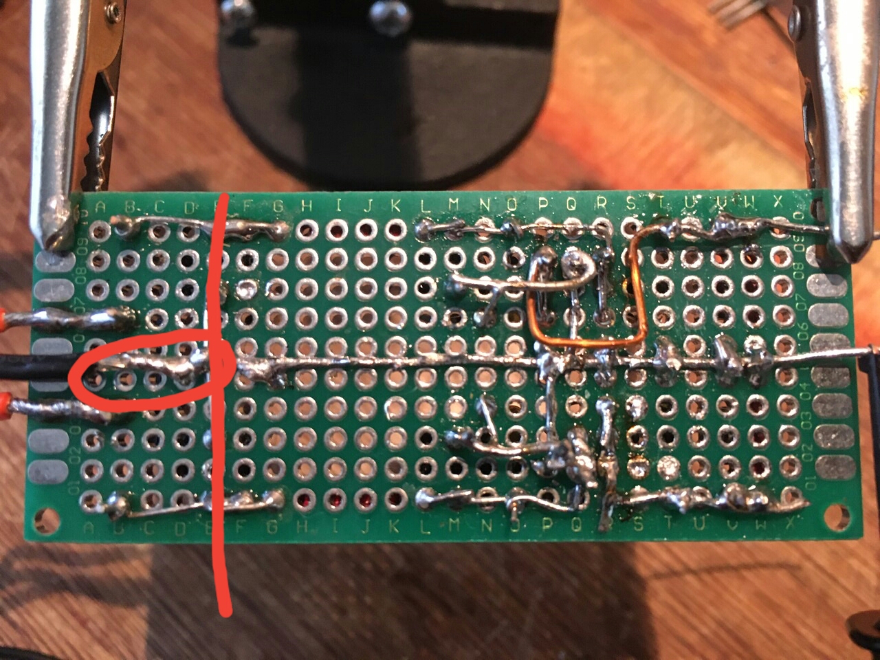

What am I missing here? The placement of the ground wire in post #14 and the wire in post 16 look identical. Yes there is a long solder tail in the first one. But the connection is at the crossing point of the wires or at most a mm past it. Could that mm make that much of a difference. The biggest change that I see is that the alligator clip is attached to a hot wire in post 16.
Here it is a difference - oval part is a bit on the left of the caps wire:

In those situations, think as you are the electrons inside the wire. Do you prefer a long way from job to house, as an example? Or do you prefer a short one? As inductances are acting as reactive elements, their "ways" are like you turn 90° at the corner in a direction apart from you way. So, again, do you prefer few turns at the corners or fewer ones
Thanks Osvaldo, it’s been an eye opening experiece.
The main difference was in moving the connection from the CT so that it wasn’t any “further down the road” than the primary capacitors.
I wonder what the mechanism is that causes the spikes to form when there is a 1cm of overlap Of wire at this point?
Thats what I was trying to tell you in post 9.
The sharp short charging impulses into the smoothing caps mustn't get into the power supply after the smoothing caps or it will modulate the ground line causing havoc.

I traced it to noise in the ground line.
I reworked the pcb having a flow through the power supply rather than just all mixed together. This time there was negligible noise on the output.
While a wire might seem like a short circuit it is in reality a resistor and an inductor. So any current through it will generate a voltage across it.
