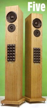

This weekend I heard the "Acoustic Induction concept" of the TL ( ¼-wave transmission line ?) Alacrity Audio Dundee 5.
Really amazing! No words to describe it...
What is this concept about? Isn't it like a real transmission line or quarter-wave?
What is there more or different from a PMC Transmission Line or others?
Really good in small room audition with very good amps and vinyl system. Really strong bass from amazingly small 135mm mid-bass driver and 20mm soft-dome tweeter 2-way.
Alacrity Audio Dundee 6 loudspeaker is similar with 160/170mm(?) driver.

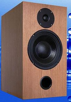

Idk what exactly that is or even how it works but it reminded me of something I heard a while back...
Atlantic Technology AT-1 loudspeaker | Stereophile.com
Not sure if the principal is the same or what but I do remember being incredibly impressed with the bass from such small drivers

The pyramid acoustic foam panels are not place on the mouth of the TL, this is in the back, but rather on a negative (depression) on the front panels and you can rest them, they are free and not attached, on top(?) of the speakers as I do with my floorstanding Focals to absorb any reflections.

Interesting article, but a completely different concept as seen through the cut-out picture of the AT1.
Alacrity Audio have overcome internal resonance colouration by allowing (or causing😕) the production of standing waves at every frequency, reasoning that a consistent cabinet performance is better as a background than an inconsistent one.😱
This by virtue of a special open-celled stuffing behind the bass driver.
I'm sure there's a bit more to it (it was awarded a full UK patent), but that's basically 'it'.

The piece of pyramid foam certainly has intrigued me at first... Another deceiving (or not!) moment.😡😀

I thought the foam at the port exit would just add resistance...like an AP vent.

No foam inside, no resistance at all. It is said that no air movement on this end of the TL. The port is in fact in the back of the speaker, on top. It is also said that position/distance to the wall has almost no affect in the sound frequencies.---
