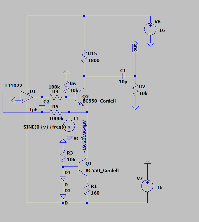

Adding BJT version with servo....
Simulated THD is 0.002% . With a nice distortion profile and low noise.

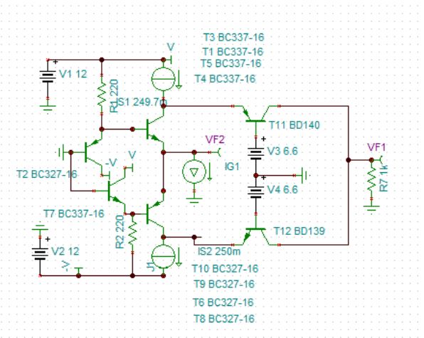

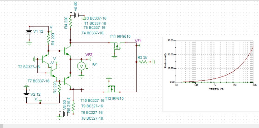

This is 4//×2 common base IV without feedback. The paralleled transistors must be matched to Ic/Vbe. From a lot of 50 transistors can for sure get matched.

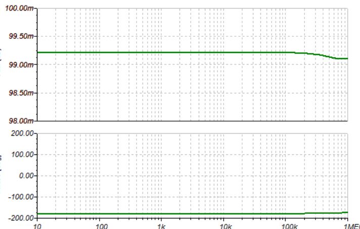

It has 0.1 ohm input impedance, 0.0007%THD but with 1vp, it goes to 0.003% with 3vp I need to solve it. The current sources have a common potentiometer to adjust the output offset and of course a servo for the input.

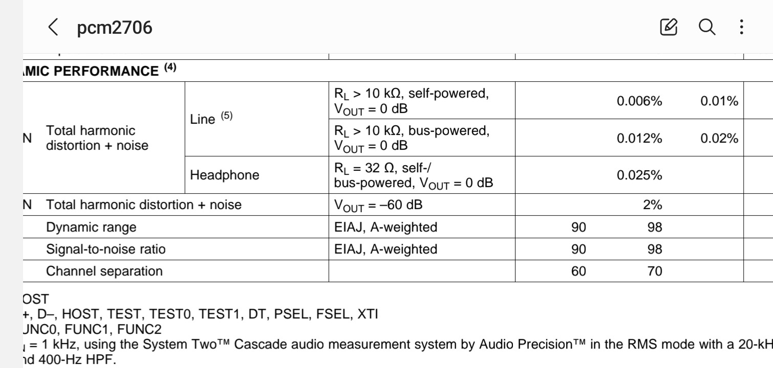

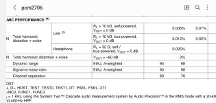

Nowadays, one can buy a decent 16bit DAC pcm2706 based for less than $15 with 0.006% THD.
DIYs decided to go NOS, but use very linear DAC ones with higher bit counts. To get still more linear, they stack in // many of these expensive components to get still better linearity.
Say that all this effort of cost and time, is to get as good sounding as Shure V could do?
If the DAC is precise, it can always be degraded by software, to sound as that particular tube amp or it can be buffered with distorting stage as Shure cartridge does.
PCM2706 DS says 0.006% THD+N. S/ N, A weighted 98db.
S/N to be 95db no weighted it is 0.0018%.
THD =0.0042%

I reached to a good result. It has now 0.00025% THD for 3vp and 12uv noise with the same 0.1 ohm input impedance. Most of the noise is generated by the mosfets but I don't know any low noise ones. I had to forget about CCS as the lowest noise is 2x25uv by dn2540.
The problem that puts this circuit into jeopardy is the 8.8W dissipation of 220 ohm each resistor.
If I model only half of the symmetry, I get 3.5uv noise. Why I am not getting 7uv instead of 12uv is another mystery.
