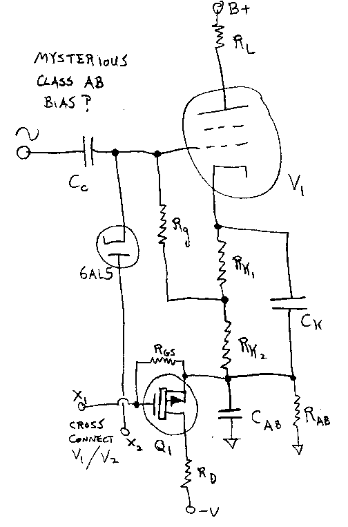

I also think the 6AL5 DC Restorer above is just fixing the DC blocking problem. The current thru the 6AL5 is telling us something though.
In keeping with the symmetry approach so far, I've added a Mosfet now to balance the auto bias during class B mode operation. The Mosfet tries to charge the Cab cap downward at the same rate that the tube charges the Ck cap upward during class B mode. (well, at half the rate, so that the mid point of Rk1 and Rk2 stays at constant voltage) Time constants of Ck/Rk1,2 and Cab/Rab would be the same, so that they can all relax back to class A conditions transparently. Cross connecting X1 and X2 is optional, but would give better tracking for assymetric signals.
Don
edit: Hmmm, on second thought, scratch this schematic, it needs to maintain constant voltage across Rk1, not relative to ground. A little re-arranging maybe......

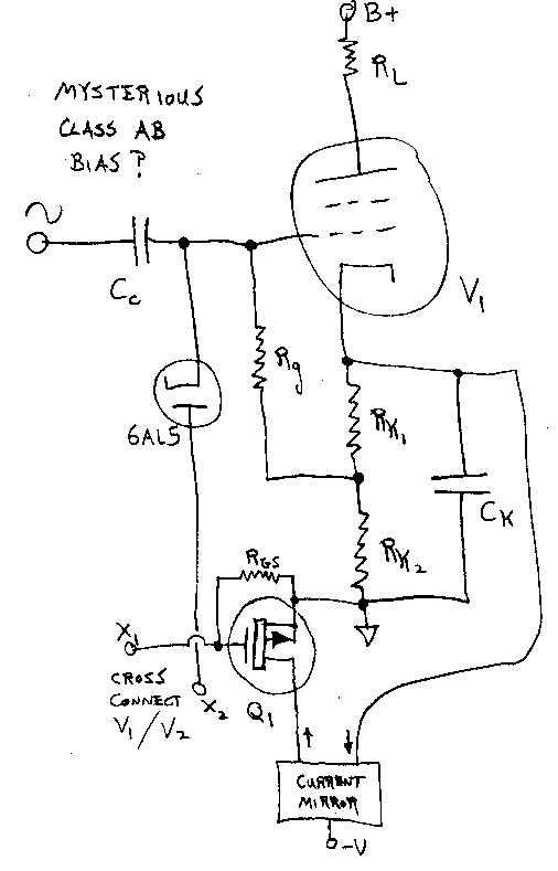

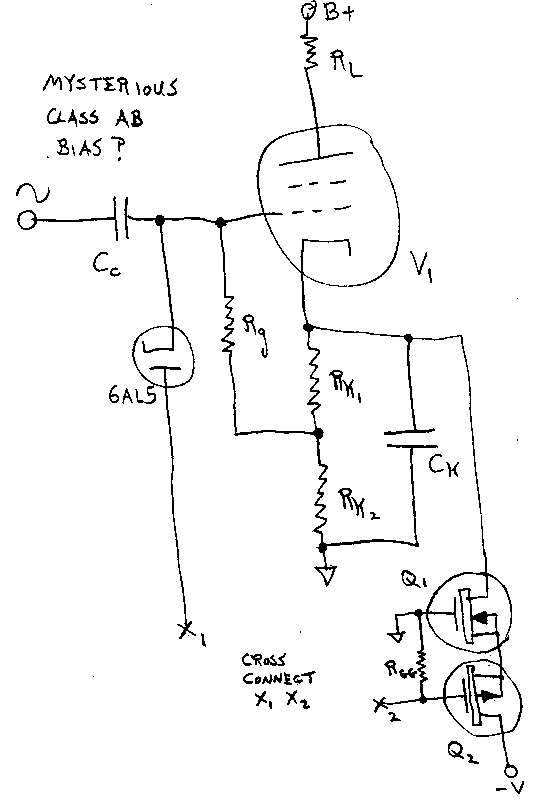

Simplified:
The Mosfets try to mimic the tube current during class B mode so that the voltage on Ck stays constant.
There should b an even better way yet. A switchable current mirror to throw the same tube current itself back at it, or just monitor the bottom of Ck for zero resultant current while in class B.
