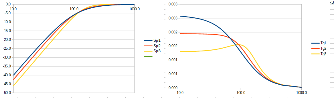

F6 = Fc = Fs*sqrt(Vas/Vb+1)
Qtc=0.577 Bessel (maximally flat delay)
This means highest Qtc with no peaking in delay
Qtc=0.707 Butterworth (maximally flat amplitude)
This is as you say, the highest Qtc with no peaking in amplitude
F3 = Fc = Fs*sqrt(Vas/Vb+1)
In the picture, case 1 is Qtc=0.5, case 2 is 0.577 and case 3 is 0.707
These responses are based on a driver that has an F3=Fc=100Hz for the Qtc=0.707 case and the box size is increased to make the other lower Qtc's. The left graph is amplitude, the right graph is group delay in seconds.
In my opinion, you would be hard pressed to tell the difference between any of these boxes in a room if the F3 were a more typical 40Hz or so rather than 100Hz. You might be able to tell with these at 100Hz.
I think you would hear the difference even at 40 hz.
With my 6th order subs outside (f3 28 hz) if I set the subsonic from 32 hz to 30 hz it seems they go subjectively almost double as low when playing corresponding music.
Just those 2 hz make more difference than one might think.

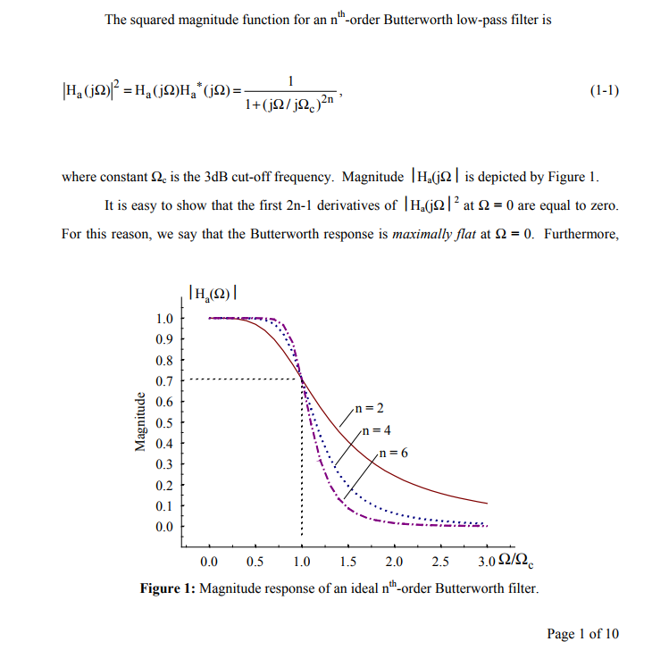

For a purely mathematical look at Butterworth low-pass filters:
http://www.ece.uah.edu/courses/ee426/Butterworth.pdf
