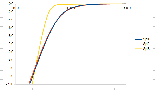

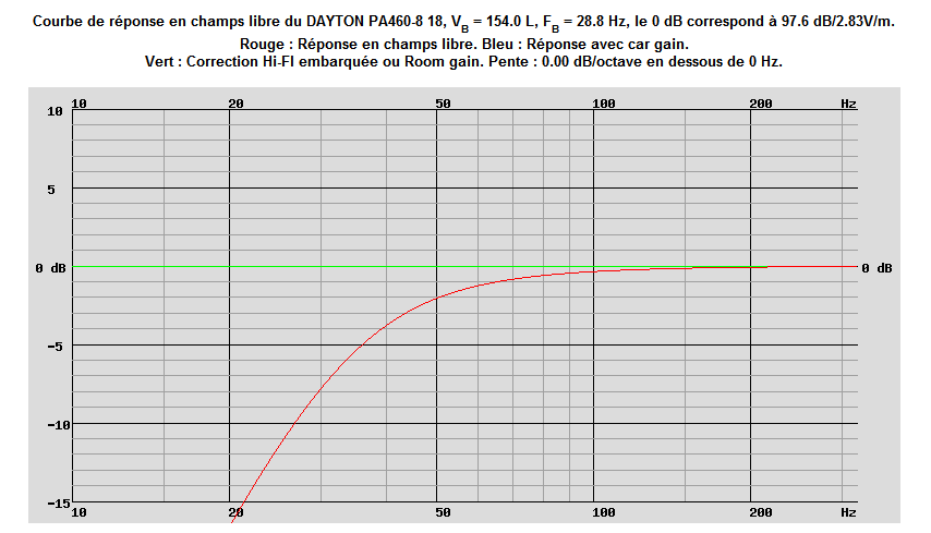

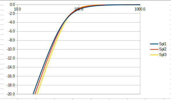

Thank you for attending to my brash suggestion. I always admire your intent to do the best for the forum.Is a "house curve" the same as a room gain profile?
Hornresp can import room/cabin gain data to add to the simulated response.
"House curve" is "desired curve" or the sound you'd like to achieve, as represented for simplicity sake by an FR curve. I couldn't say if it can be achieved within your respected sim the same as inputting "a room gain profile". But might be. And if so, you could encourage people to do it. I'm trying to remember how REW handles house curves - it's in there somewhere.
