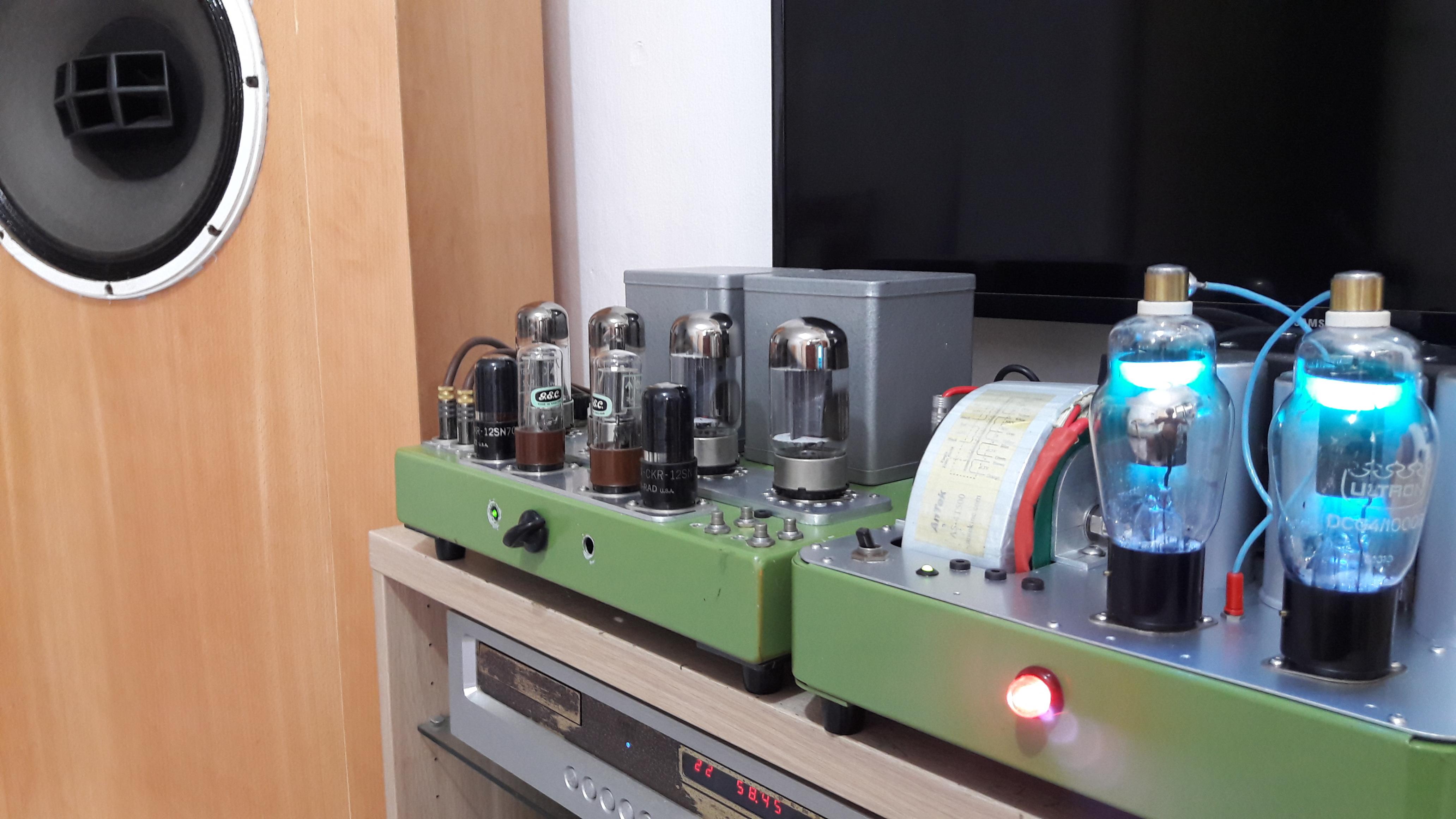

My power supply is damn quite, no hum, no thump, done without stimulation. Using 2x Hammond 159v wired in parallel connected to the center tap of my 500-0-500 Antek. The rest if 12uf > 5H > 60uf > 5H 60uf for a 495v@230mA load.
