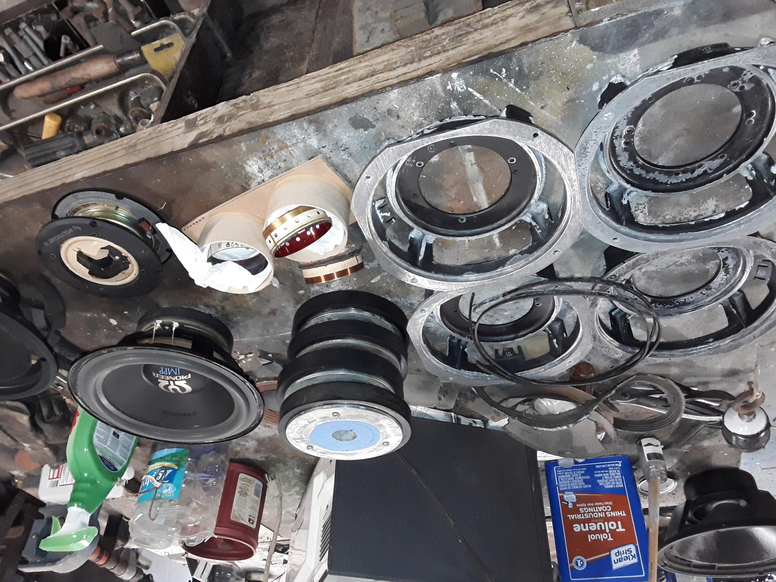

for the visually stimulated
Here is my partial line up of repairs.

Does it soften with humidity? Humidity is a Major issue here 3 miles inland in central Florida were every metal corrodes and anything that can absorb water does it to the limit. even inside your close garage without year round climate control.
Found someone talking about cellulose glue and that sounds like something I need to put in my bag of tricks, for some special applications. what I thought was PVA is apparently latex, and I picked up some weildwood contact, I have experience with it on counter tops , should work good with excellent preparation.
