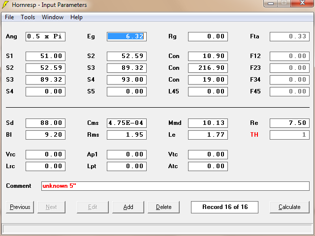

Here are the TSP:
fs = 72,6 Hz
Re = 7,5 Ohm
Qes = 0,41
Qms = 2,37
Qts = 0,35
Vas = 5,25 L
Cms = 0,47 mm/N
Mms = 10,13 g
Sd = 88 cm²
BxL = 9,2 N/A
Rms = 1,9 kg/s
Le = 1,77 mH

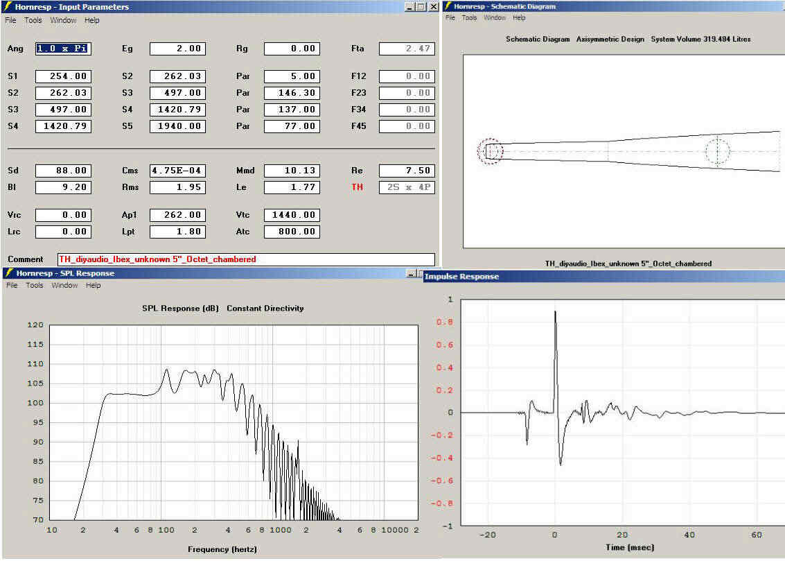

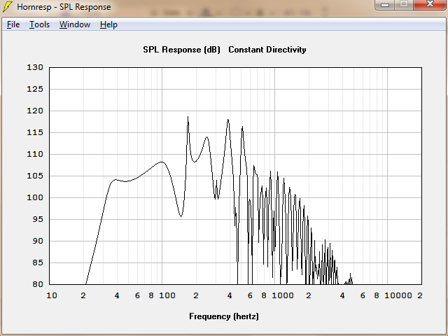

Here's a tapped horn design, and tweak in horn resp as desired. The throat size is too small, so my suggestion would be to use a multiple of drivers (say 2), and increase all the cross sectional areas by that number.
I don't know what X max is but I managed to drag response down to 40 Hz (about an octave below driver Fs) where you're Xmax limited to 5 watt input per driver . SPL at that point is about 105 - 110 db, with room gain flattening out the response.

I added the throat chamber as an option, and to minimize the L12 distance. Shortening L12 strongly affects the impulse response. Without knowing the rough external dimensions desired this looked like a reasonable first stab at a simulation.
As to the Xmax, even if you add half the gap depth you don't come anywhere close to what you would like to see in a driver build for subwoofer duty (see Post #4 by GM).

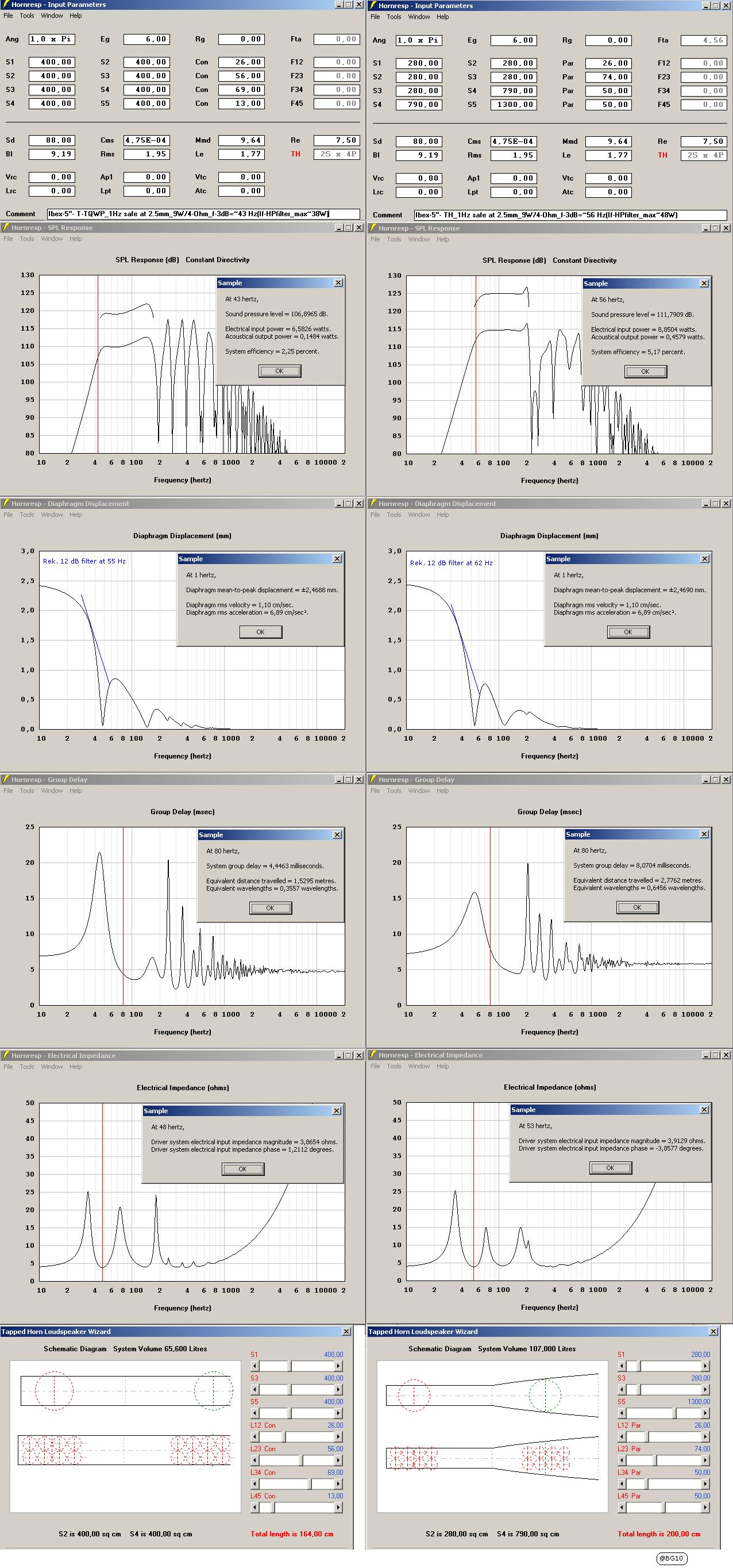

(10.5-5.25)/2 = ~2.63 mm, so the 3 mm I used is close enough for an acceptable distortion limit.
Input it into Oliver's design to find out and play with the Wizard to find an acceptable trade-off between LF extension, mid-bass 'punch' capability and boundary loading.

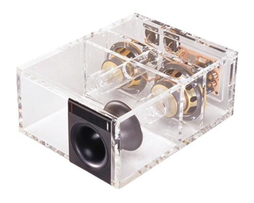

How knows what those bose type acoustimass drivers are able to do, what excursion are they capable?
They 'squeeze' two or three cheap drivers very hard in a narrow BW 6th or 8th order BP (TP, TH, TTQWT, Karlson K15 are 8th order) and EQ it to suit:
Bose AM-15
BASS MODULE
F3 = 280/220 Hz
F6 = 46/40 Hz
Response measured with 2.8 volts of pink-noise input.
GM

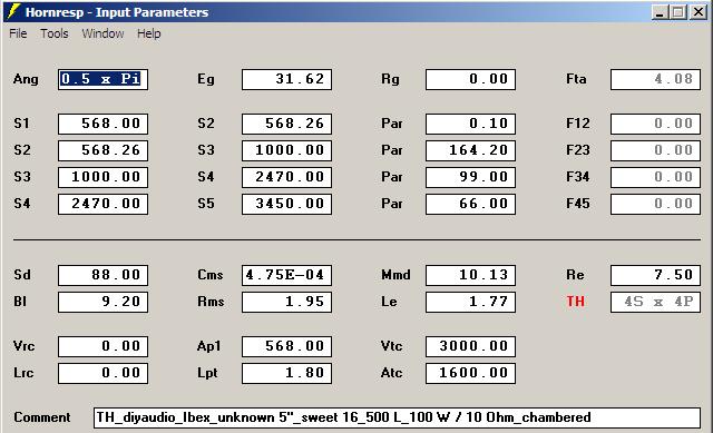

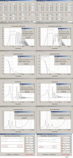

Hi Ibex,
I like the tapped horn approach, but you should first refine your application data. Is it for the home? Would couch risers a la TH-SPUD be what you are looking for, how about multiple subs (e.g.: 4 or more subs for one room), what about subs that double as speaker stands for the main L/R?
Here is one more simulation that will need a very solid room corner: 500 Liter net; if the Re is 7.5 Ohm this would probably qualify as a 10 Ohm speaker, let's see 100W into 10 Ohm and SPL response above 130dB with 3.5mm excursion @ 30Hz. That sounds pretty cool.
