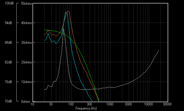

what effect does a 4 driver have on an 8 ohm crossover?
......and text book component values as I would expect in this unit.
well, we assume a 150hz xo point, because it says so
its obviously a calculated xo
and we know for a fact that it would have delayed function in real life
low crossing inductors always needs to be bigger than calculated
sometimes quite a lot
and with such low xo point, even more
as said earlier, the 150hz xo point would be more likely to happen now, with 4ohm instead 8ohm
I would be very surpriced if it would be much lower than that
Allen, the very low xo point you show in the third graph is unlikely to be that low with such small inductors
thats why I question it
There is something in what you are saying. I decided that I didn't feel the impedance I used for the sub was a good example so I changed to another woofer and this time I have displayed the impedance.
needs to be bigger than calculated sometimes
This being one of those sometimes cases as the impedance is falling at these low frequencies, not rising as it usually does near a crossover point.
The ideal plot is in green. 8 ohm is orange, 4 ohm is blue (same impedance plot used but filter Q halved), and the impedance is in grey.

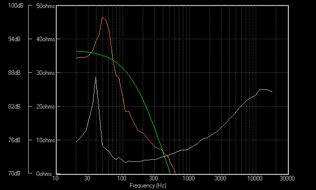

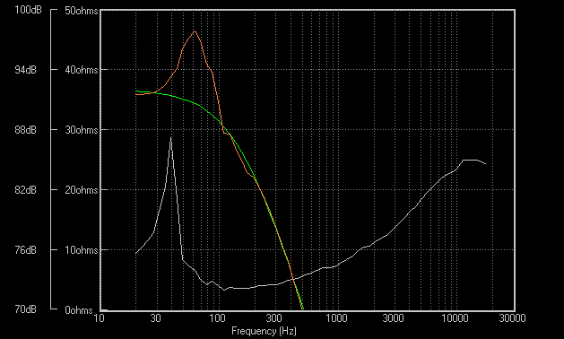

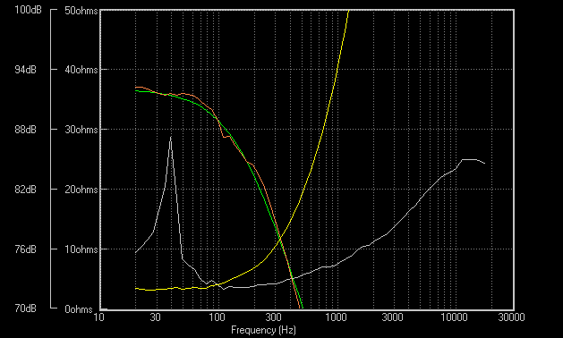

I agree. I found what looks like a 4 ohm driver with a lower resonance hoping this will be more helpful. I managed the second plot by more than halving the inductance and tripling the capacitance. The third has an inductor 2.6 times smaller and capacitance quadruple the original, as well as a resonance peak filter.

sure wish i knew what parts to solder (and where to solder them) into my cheapo x over to make it perform like graph 3 🙁
Since you asked...but these values may not quite work for your woofer.
