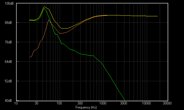

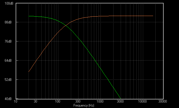

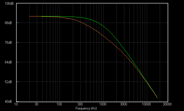

The way it does this is by controlling the response near the knee. I've attached a plot that shows a 150Hz filter working into an 8 ohm resistor (green) and a 4 ohm resistor.

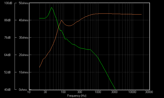

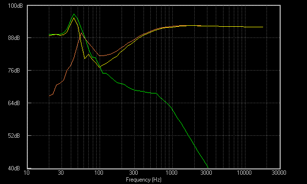

Second plot is how the filter should ideally work, and third shows real drivers - a 4 ohm 15" driver and an 8 ohm 6" driver.

No, in the first graph it is 8 ohm versus 4 ohm. The others show the high pass section and the low pass section.
For the second and third, I modelled a second order high pass instead of first order by mistake (low pass is correct) but it really doesn't matter, the carnage is identified pretty much as I intended.
The third image is the way it is because drivers don't behave like resistors. The fact that it is 4 ohm versus 8 ohm really becomes a minor issue here. Trying to cross woofers over passively at the low end without regard for their impedance variations, is the greater issue.

so you don't have any info for the third graph showing summed output
at least thats how I see it

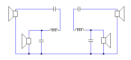

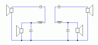

Hmmm, I'll describe what I see in it. Two inductors and four caps. It claims stereo and it claims two way. It claims 12dB low and 6dB high. It shows stereo inputs and stereo outputs, and also claims to have stereo outputs as flyleads meant to be connected to the subs inside the box that it is mounted on.
I'm guessing it's something like this.
ah, ok, my mistake, you are absolutely correct, sorry
wires for the subs, and output terminal goes to main speakers, ofcourse
still, you need to know the acoustic rolloff of the main speakers to predict anything
so I would still question the third graph
probably works best with a small 5" in closed box
or other driver with high Fs
and lowish Qts for early rolloff
I might be tempted to paralel the two caps, and have no xo on main speakers
Wired in phase and out.
I should point out that the sim uses real impedance information (with phase) and text book component values as I would expect in this unit.
The sim uses flat responses not real speakers. This is to display the transfer functions. It is also why I didn't include the summed responses. I thought the graphs served their purpose of illustration as best as I intended but please note these limitations.
