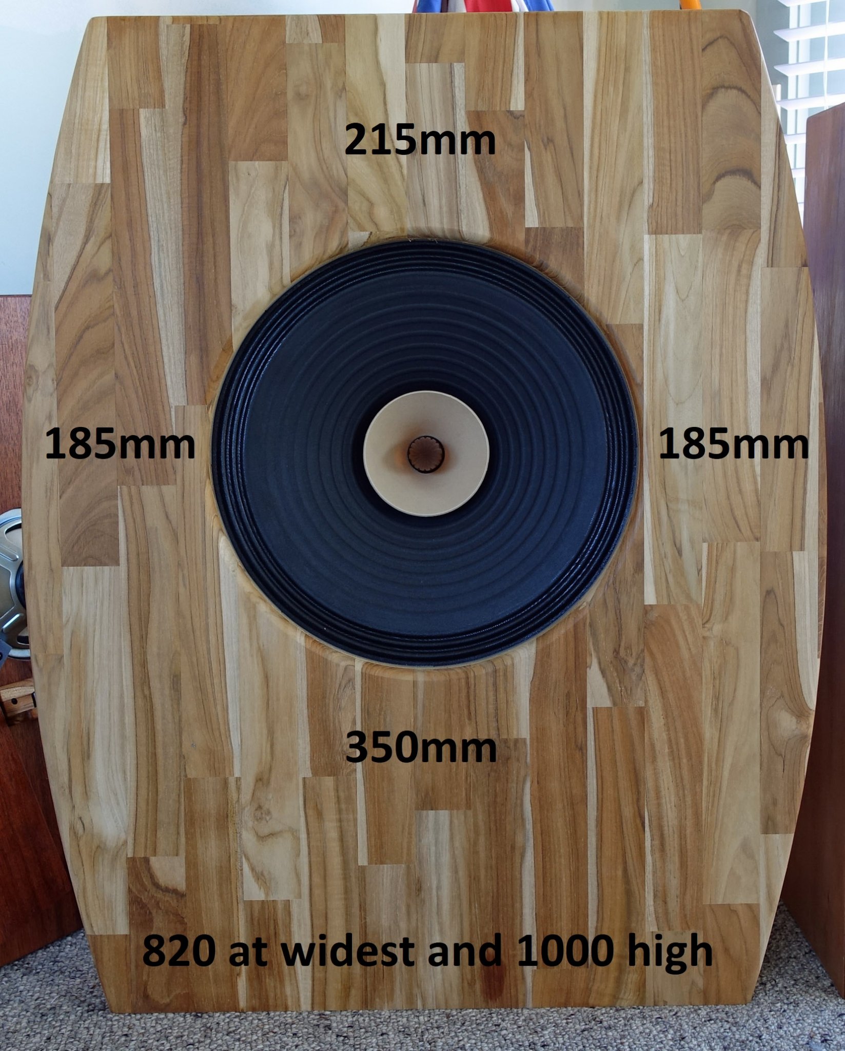

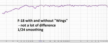

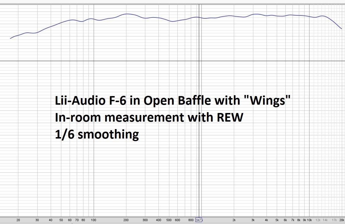

My first open baffle speakers (indeed, my first speaker build) was F-18 as open baffle. I absolutely love them, and they are beautiful with my 35 watts per channel Dynaco ST-70 KT77 PP tube amp. Actually, the F-18s were slow to come from China and Lii-Audio kindly sent me a pair of F-6 speakers while I waited (free of any cost to me!). So before my F-18s arrived, I mounted the F6s on a 1" timber board 24" wide by 36" high, with hinge-out back "wings" which double as prop stands. These F6 OB speakers are fantastic and measure up well - see below.
The F-18s are completed now - on 35mm thick timber.
I've also made the Manazitas that Sean C recommends - these are possibly technically better speakers but the volume they put out is much less than the F-6s and very much less than the F-18s and I prefer jazz and blues from the ST-70 through my F-6s or F-18s. I use an Aiyima A08 to drive the Manazitas.
I recommend the F-18s but I think if I had my time again, I could easily go with the F-15s. The F-18s are very spectacular and impressive (ie, huge) and that is why I chose them. They certainly deliver! If you have not seen it yet, this guy built both F-15 and F-18 open baffle and compares them: http://www.glowinthedarkaudio.com/speakers.html
Anyway, have fun and good luck with your first DIY project - I'm sure there will be many more!

What a coincidence: this is my first open baffle experience and I decided to go for the F-18. Size of baffle 120x70cm and wings add another 30cm per side. Amplification is a Sabaj A20a and I am totally thrilled by the transparency and size of soundstage of this design. As I also do not find it shouty it is an extremely worthwhile "experiment" - so enjoy!

I would like to build open baffles with Lii Audio f18-s too . Would be very grateful if you can give me an advice on the size of the baffles - I can see that Simons design is based on Betsy shape and without wings , and others 70x120 cm size with the wings . any feedbacks or more photos with finished baffles . would appreciate any help guys . Thank you . Val
