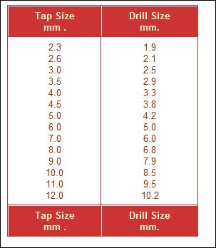

A real quick question from a newbie. What size drill bit should one use to make holes (on a heat sink) that are suitable to be tapped for M3 screws? It seems that I can only find drill bit in imperial scale? Would a 1/8 (0.125) inch drill bit work for the M3 (0.118) ? Thanks!

Hi Maybe this will help.
Ian
Sure - You can give 7/64 a try on a scrap piece to test how it goes with a tap and fastener. Aluminum being soft be careful to not over torque the M3 fasteners and strip out the hole.

Metric threads have been made easy for us since they adopted a 60degree thread face angle.
Take the screw thread size and subtract the pitch.
eg M3 0.5mm pitch needs a 2.5mm drill.
In hard materials (steel) you can drill slightly bigger than 2.5mm to make for easier tapping and this gives slightly less engagement.
In softer materials (aluminium) you can drill slightly smaller than 2.5mm to ensure full engagement of the male and female threads.
The extreme form of this are the thread forming taps, rather than the thread cutting taps.
Note "slightly".
The total engagement of that M3 0.5mm pitch is only 0.25mm. Take 10% off that for 0.225mm engagement results in the required hole size being 2.55mm diameter. 80% engagement requires a 2.6mm diameter hole.
