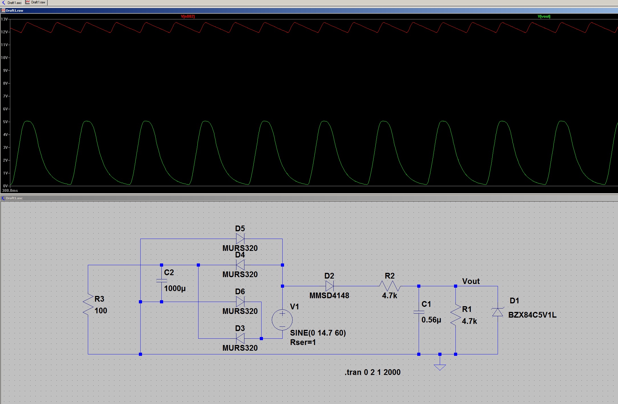

13.4VAC sounds a bit high.
I did a simulation with 11.3VAC and it puts out a DC voltage just above 13V at 135mA load current, which seems to be comfortable for the relays and their protection resistors. The red trace shows the DC voltage after the diode bridge, the green trace shows the wave form at the 5.1V zener D458. I'll post another simulation with a 18VDC and see how much difference there would be.

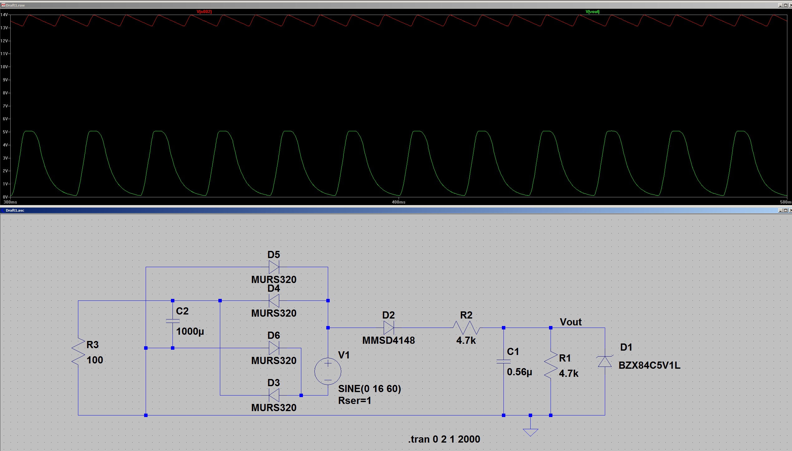

With a transformer that puts out 18VDC @180mA load current, there isn't much change to the waveform at D458. But the relays may not be spec-ed to operate at such a voltage even with the 33-ohm protection resistors in place, and you may want to be careful. I'm not saying it will not work though.

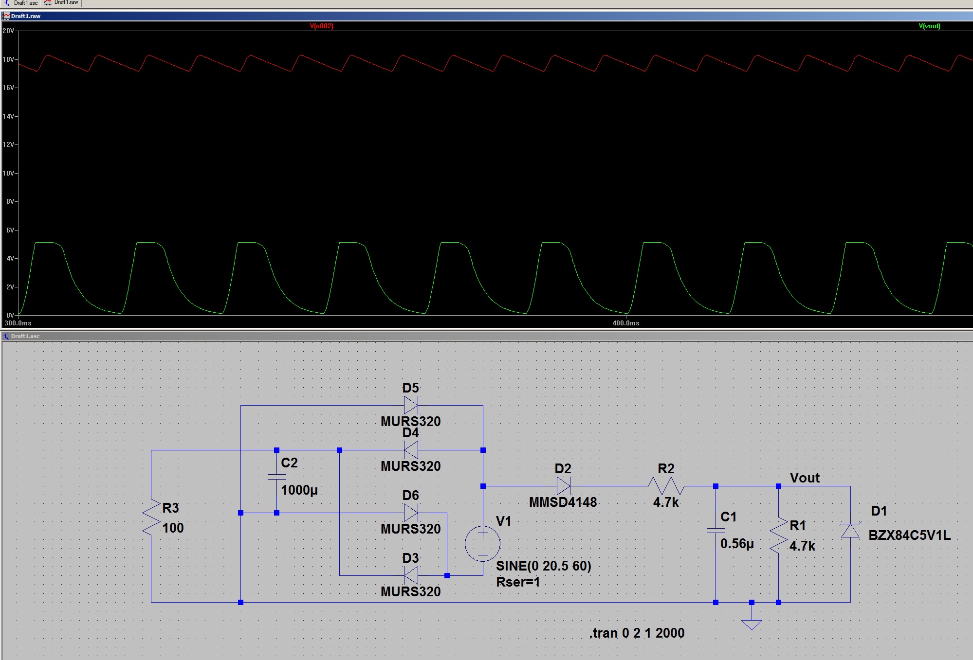

I too suspect the problem isn't with the power board. Even with a 10.4VAC trans the DC voltage output is still above 12V, more than enough to operate the relays with the 33-ohm resistors in place. See simulation below. But you may still want to first rule out the power supply and the relay drive circuits prior to troubleshooting elsewhere. So do the test I proposed. You can do it with the 10.4V trans.
I also noticed from reviewing the previous posts that you probably never mentioned the standby LED, when you turn the power on/off with the tack switch or a remote, the LED should change color. Did you ever see that happened?
