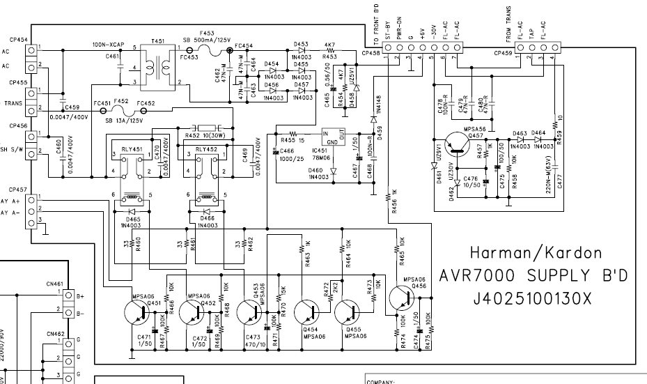

To start the sequence you need to enable Q456 by applying a positive voltage to the base. This will enable Q455 > enable Q454 >Q455 will delay and then Q453 will enable relay 452. If you have a positive voltage at the Q456 then

I think you can do a test by removing 458 connector and with a 1K resistor momentary jump 4 and 1 and all relays should pickup. If everything it is OKAY.
The problem we were looking for 5 volts at pin 2 it is that for the micro to see a logical one the voltage should be 3 volts or higher. Below 3 it can be a zero. The micro it is the one that enable the relays by sending a signal to enable the relays. I am not sure if for the micro to enable the relay it need pin 2 high. That is why we are looking a 5 at pin.
I would not design a power monitor the way you said.
By the circuit shown in the schematic Pin2 is supposed to have a saw-tooth wave form with a flat top at 5V, and a bottom can be as low as near 1V. I don't know what circuit in the micro board looks like, but if I was the designer i'd feed this wave form into an NPN transistor inverter's base, when the mains power is good, this transistor always saturates and outputs a logic 0.
C465 is charged to 5V by the positive cycle of AC, and is discharged by R454 between charge cycles. The time constant of C465*R454 makes sure as few as one missing charge cycle will cause C465 be dicharged to below the threshold of the NPN transistor inverter, causing a logic "1" at its out put. This is supposed to be a very reliable power failure detector and it has a maximum response time of 16.7 mS.

2.78VDC is just an average of that sawtooth waveform shown on a multimeter when one choose to measure with. It tells very little by itself if not nothing. And I'm quite sure an engineer will not feed a sawtooth into an A/D in a consumer electronics micro for a purpose of power failure detection in a real world. There are so many other ways to do it, far simpler and far more reliable and straight forward. An NPN transistor inverter following pin2 is a good example that reliably and quickly provides a logic 0/1 when AC power is good/failure.
Srinath, can you post the schematic showing the circuit around the micro, on the other side of CP458? it should give a bigger picture and help understand the operation of the power board and its controls.

Finally getting back to this - life gets in the way, then you forget.
Anyway I had pretty much traced the problem to a bad soft start board transformer.
T451 in this diagram. The secondary tested like a capacitor, showing a resistance and promptly flipping to open.

Check this power transformer in Mouser. Mouser part number 838-3FS-516.
See if the pins are compatible with your board. The transformer it is 16 volts and .800 amps. The relays are 12 volts dc. I think you can use this transformer with no problem or if you have space you can buy one with leads and solder the wires in the boards eyelets for the transformer.

If you think it is too high then go to the 838-3FS-412. This one the output voltage it is 12.6 volts. The 3 relays are 12 volts DC.
The transformer may be only 9Vac.
After the bridge rectifier it will give anywhere from 11Vdc (fully loaded) to 15Vdc(lightly loaded)

Which winding was open? Sometime some manufacture installed a small thermal fuse in the primary. If the transformer get hotted the fuse will open permanently and need replacement.
I believe secondary was open, I dont recall I will read through my old posts its been 6 months. I will check to be sure.
