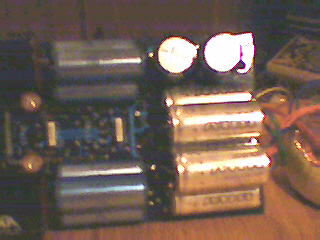

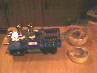

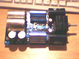

I finaly made a board and build that darn thing...
Sorry for the poor quality of the pictures but ill post better ones when i get the casing done..
Btw the pcb:s size is eurocard (100x160mm)
