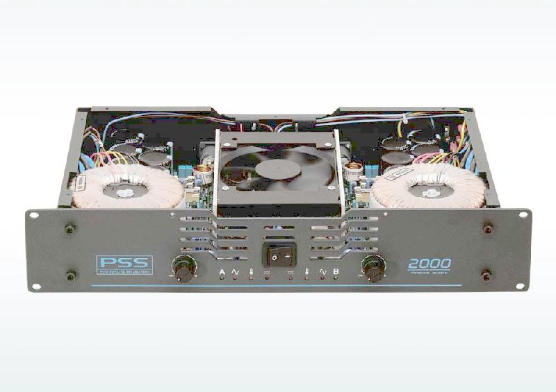

Jens (I’m replying on the same board),
As we have a unique cooling system (dare have a look at it), with the "hot air" we get from the sides of our “small” heat sink, this air blows directly towards the capacitors, transformers and all power components!
You keeping the caps warm for sonics reasons ?.
Best to keep the transformer as cool as possible I reckon.
Better still to have two seperate incoming cool air paths to the output semis sections and the psu sections.
I believe electros can be quite strongly temperature dependent, with lower ESR when warmer.
Also explains some of the warm up sonics changes in amplifiers.
With such a system, we also lower from about 15% their temperature ...

Our transformers are manufactured by TOROID, a Swedish company (www.toroid.com).
I am deeply involved and interested in sound quality but I do not use any FET as I stick to bipolar transistors!
I use our unique cooling system since 5 years now, a lot of person were and are still surprised that we can use a so small and light heat sink, but when you get it at work, it works!
Since the first drawing, I made some modification and it will even be improved in the next weeks as we must pull from this heat sink (45x130x45 - U shape; 200 mm long and 4-5 mm thick) 1200 Watts under 4 ohms with a 120x120x38 mm regulated fan.
About the twin bridges, I can say that I pull this information from several French technical and hobbyist magazines and my experience is:
Before using round transformers I only used square ones, that we manufactured, with a single bridge and had a warm sound.
I always said that round transformers are giving a hard sound (see my article posted on our website about it).
When I went into slim amplifiers I tried some round transformers and had the most horrible sound I ever heard with an amplifier that I was used to listen at before with a square transformer.

About DC voltage: As one can see it is not a class A but an AB class schematic and it is not hand written on a note pad sheet.
It is true that in class A one uses 63V caps ran at 50% of their voltage capacity as those caps are always flown by a big “idle” current! In such a case to keep a long lifetime for those capacitors it is preferable not to use them close to their voltage limits.
This is untrue with AB amplifiers, that is why one can use it close to his voltage tolerance as everybody should know (unless using a 10 time more powerful transformer): when voltage is high, current is low; when current is high, voltage goes down!
