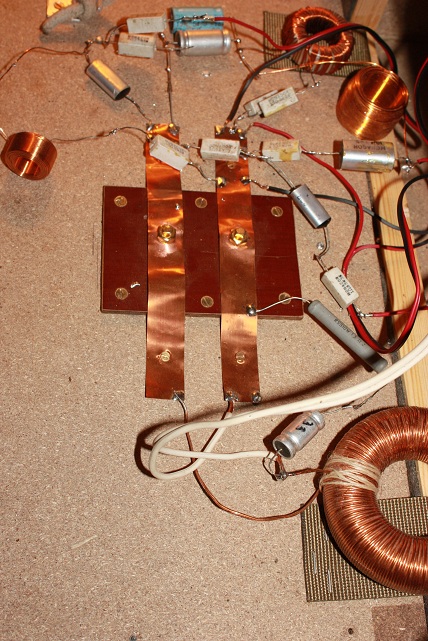

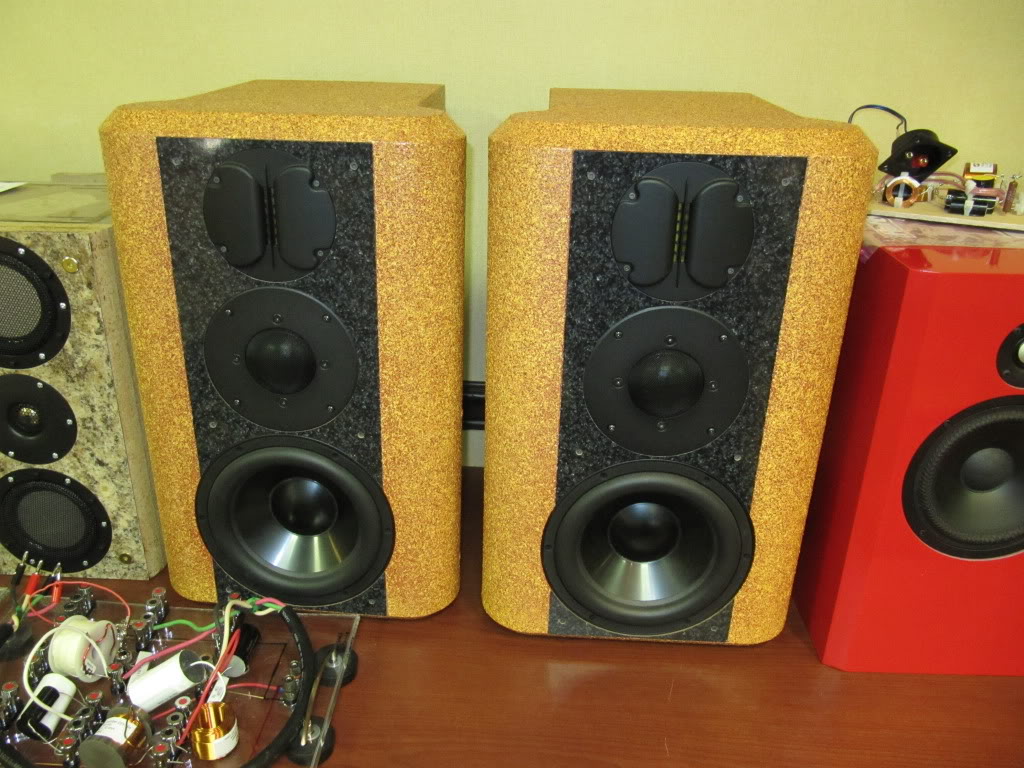

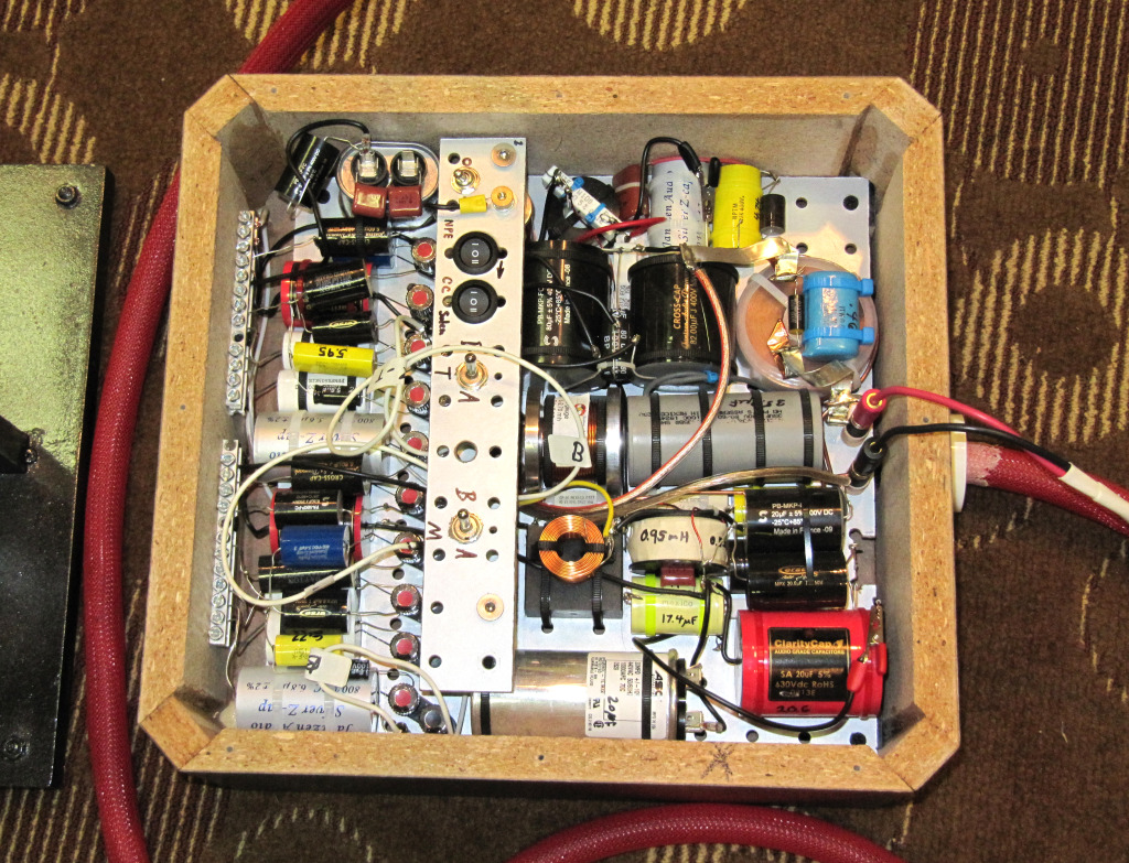

I once saw a 21 component passive 3 way XO that begs to differ. 🙂
I like the ease and versatility of an active unit, the expensive part is having an amp on hand for each pair of drivers. If you have that then...
Coulda been mine.... 21 parts, plus input LCR conjugate. Schematic not currently released on-line.
Pano remembers them... 😉
Later,
Wolf
hey Wolf, impressive and tricky looking xo
had to count my xo components
only 16, and about half of them 'just' resistors
well, there's a couple free hanging 'non active' resistors, from experiments
but I hesitate to completely remove them, yet
because I know from many other experiences that something changes when they are removed
even if they are only connect at one end
sound silly, eh
