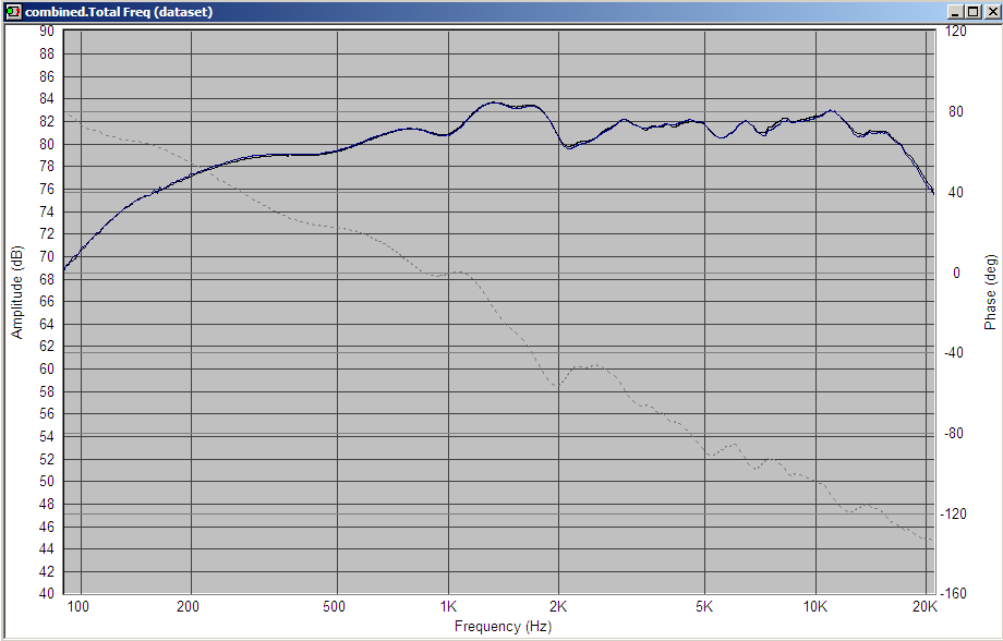

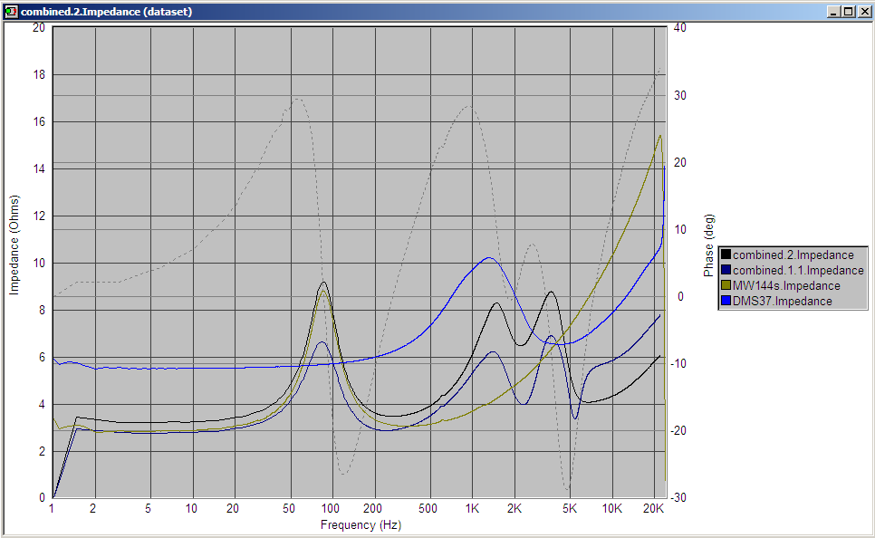

Abrax, yes the dip is in the simulation. I've not yet done the new crossover. I wound the last two coils today, and still have two to dip in varnish. I've found speaker-workshops simulation to be very close to actual results (at least for spl) I've not compared simmed vs actual impedance.
1st pic impeadances, 2nd pic simmed crossover (black) vs actual measured crossover blue. I guess this could come under the trials and tribulations of passive crossover design (a + for active) but It is getting off topic, so if you want to discuss more I should open another thread 🙂 edit: you can see from the spl curve why I added in the notch at 1.4K 😉 also I know the impedance curve looks like a roller coaster, but thats because of the two notches on the midbass'
