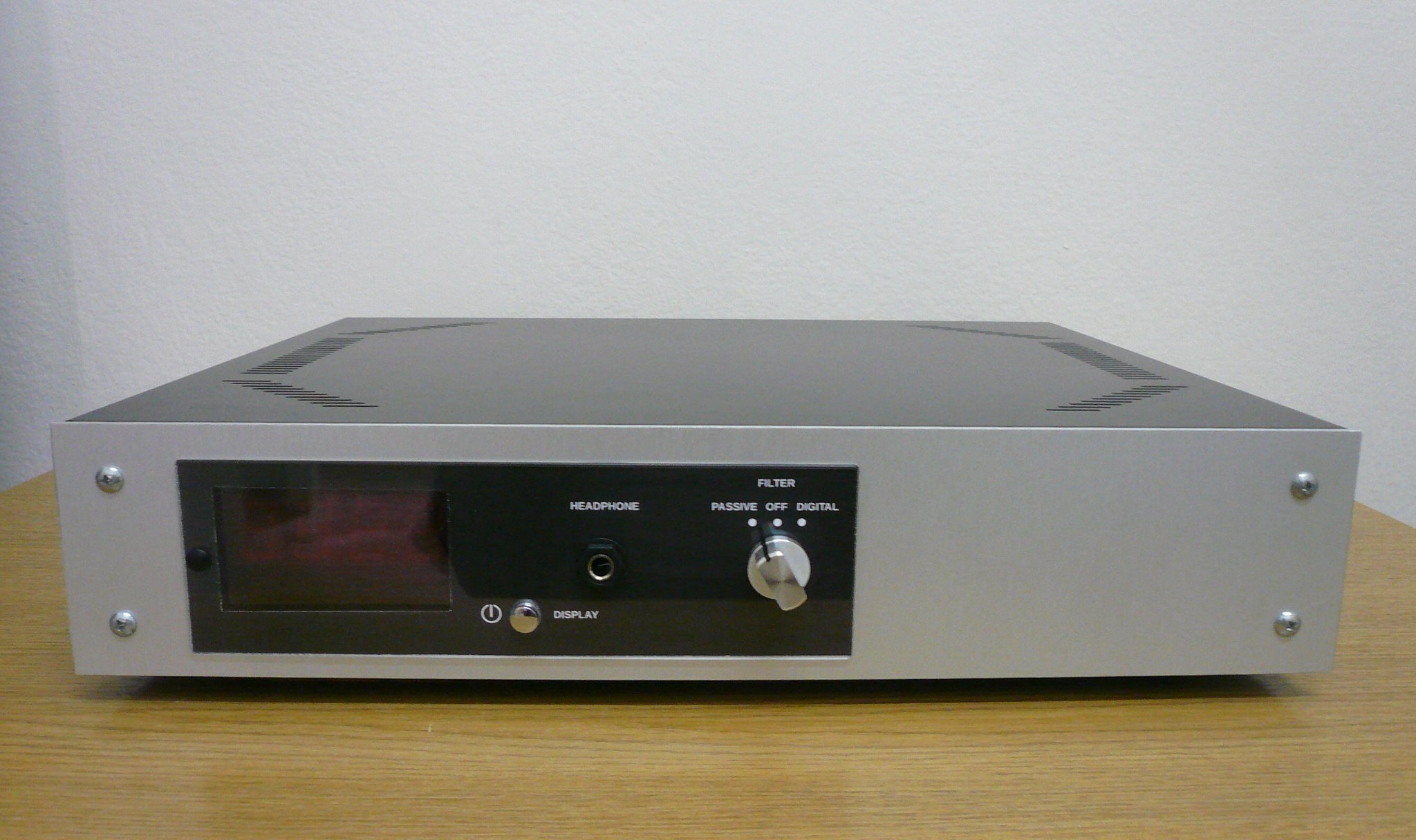

I find having sinc droop correction increase dinamics, and that boosted high end brings out what i perceive as more detailed sound. But it does takes it's toll (not that much though) a bit on sound stage, and what is usually described as vivid. Honestly, best to have is a switch, and listen to what feels good at that particular moment 🙂
That's what I did 🙂
