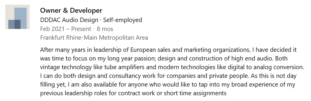

So do I, and leave the troll calling high end audio developers to pursue their business. Hiding a business plan behind the DIY label is apparently the nom du jour.
And some are still wondering why I have no issues with those operating a small business here, without smoke screens, false/outrageous claims, name calling, insulting everybody's intelligence, etc...
