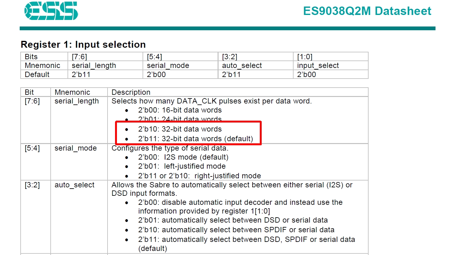

USB can pass 32-bits. I2SoverUSB and most other USB boards output 32-bits by default. ESS dac chips do internal processing at 32-bits (not to say that the dac output operates at more than 24-bits, however). Etc.
The AES-3 standard is for SPDIF/TOSLINK/AES type digital audio interface signals; its not for USB.

Although the I2S word length can be 32-bit, many DACs only accept up to 24-bit PCM packed within those 32 bits. Or they'll just truncate the LSB by 8 bits. Indeed it's better to output 24-bit reduced and dithered in software, then to feed 32-bit to a DAC that'll truncate. So be sure to separate "transport bit depth" from "data bit depth" within that transport and double check how that is for your gear.
I think that holds true for the ESS DACs as well -- 24 bit samples internally processed in 32 bit integer math.

ESS data sheet says 32-bit input data is the default configuration. They also say their internal volume control runs at 32-bits. They don't say anything about truncation although it presumably occurs at some point prior to the switched resistor output.
One answer came from Markw4. By example, DSD native transfers are 32-bit, not 24-bit (?). Amanero Combo 384 decoding 32-bit, I2S pass 32-bit as well. Truncation can happen on a DAC. Foobar will truncate 32-bit source if 24-bit outptut option is selected. Dithering option is only available when selecting 16-bit.So, to summarize in a small post before I'm accused for thread hijacking... Since usb can only pass up to 24bit, setting Foobar output for 32bit most likely results to truncation so, better 24bit output. WaveIO is capable for 32bit. Could the remaining depth be useful when attenuating? It would mean a conversion right there to start with. Would it be floating point and dithered? I can only say that the digital volume control seems to be at the Xmos microcontroller's drivers. From my side, I built my system with a gain structure that keeps the volume control slider higher than half way.

Hi Mark,
Thx for your input regarding USB enabling 32 bit transfer.
And yes I agree, in that case when converting USB to I2S still enables the full 32 bits.
What you will need is a Dac with USB input, hoping that this is directly converted to I2S and not to AES-3 for an SRC that is doing the OS.
The relevant question is though, do we really need this 32 bit.
Of course for intermediate processing you will need much more bits, but isn’t 24 bit more than enough for the final file ?
