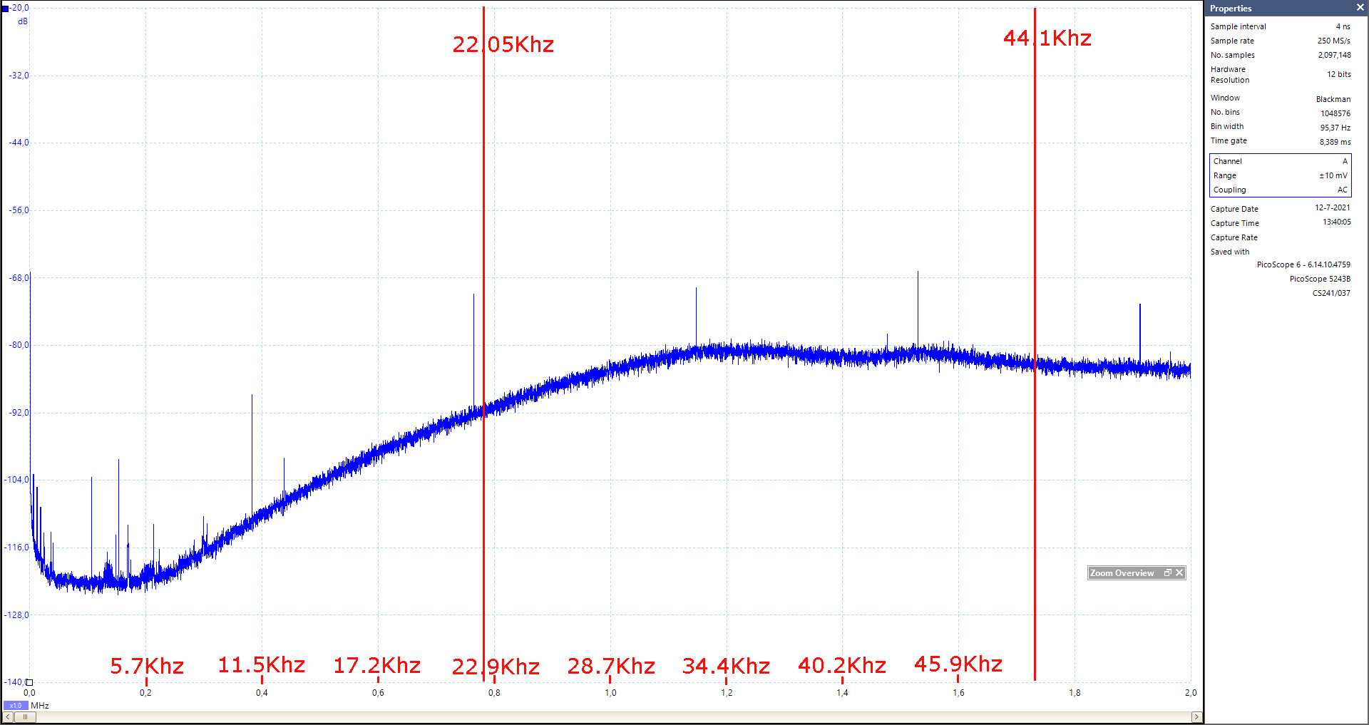

Further to Marcel's SDM exposure, isn't an important reason for the 8Fs up-sampler in front of the SDM to enable the SDM to operate at 64Fs, quite a bit above audio frequencies needed for an effective 40dB noise shaping action as is the case for the 179X.
So removing the 8Fs upsampler and driving the SDM with 8Fs instead of at 64Fs with up-sampler, means that the whole noise shaping envelope already shifts a factor 8 to the left in frequency.
As an example see the image below showing the SDM noise shaped spectrum as measured on a 25R load when Fs is 192Khz and the SDM operates at 64Fs=12.288Mhz on a scale from 0 to 2.0Mhz
Reducing the SDM input frequency to 44.1Khz input in NOS mode, will let it operate at 8Fs=352.8Khz, or at a almost 35 times lower frequency as in the shown recording, shifting the whole picture below a factor 35 in frequency to the left.
See the adjusted frequencies in red in the image, plus the Fs=44.1Khz.
The spectral lines between 60Khz and 200K in the original image are caused by an SMPS feeding the DAC and have nothing to do with the SDM.
In case of Fs=44.1Khz they will shift a factor 35 upwards.
So what I wanted to show is that using no up-sampler in front of the SDM will increase the noise by a significant amount in the audio range.
Hans

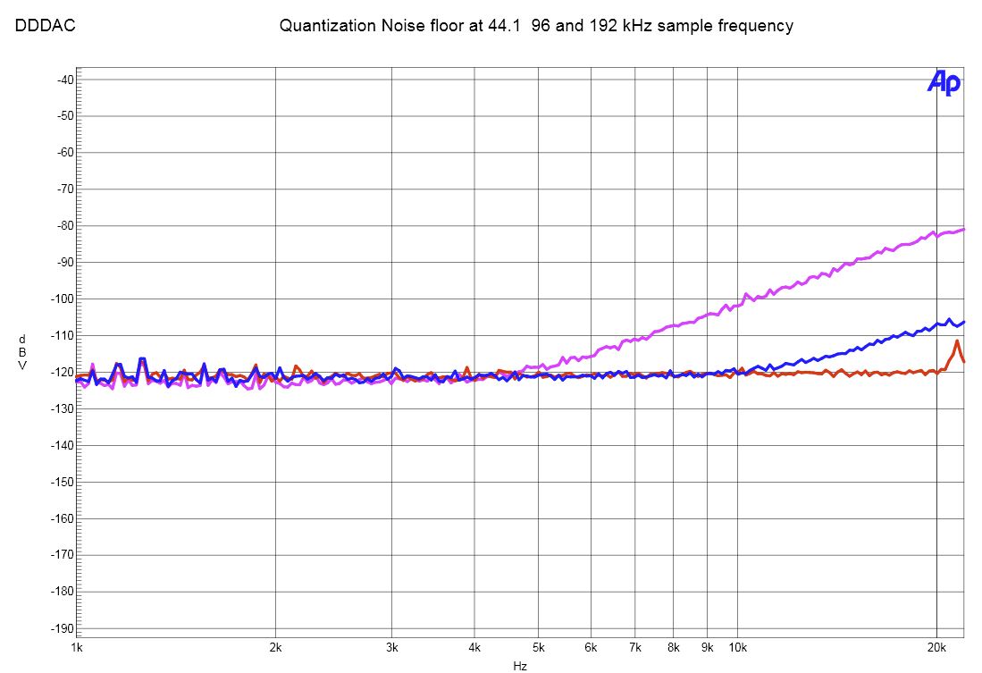

Correct Hans,
as there is no extra 8FS up-sampling and FIR filtering, the noise shifts to the left so to speak
I wrote about this on my website a few years ago.
The positive thing was that as I did not use any digital filtering (FIR), like in the PCM chip or with external digital filters, by using BCK as System clock.
The sound came out as typical NOS. I could compare this with my in those days active DDDAC1543 project, which run over many years and had/has also hundreds of user. Including Jean Hiraga who loved both versions (as it sounded so nicely NOS)
I measured this noise curve depending on FS, see below link

Doede,
Thx for the link. For 44.1Khz, it corresponds relatively well with my graph.

Doede,
So long story short for PCM179X at 44.1Khz in NOS mode:
- yes the SDM noise intrudes quite a bit into the audio range and
- no this SDM noise doesn’t reach a level where it interferes in any audible way with the music reproduction, further confirmed by you with a perfect PGGB 88.2 upsampling where SDM noise is practically shifted out of the audio range that gave no benefit in sound reproduction.
Is this a correct resume ?
