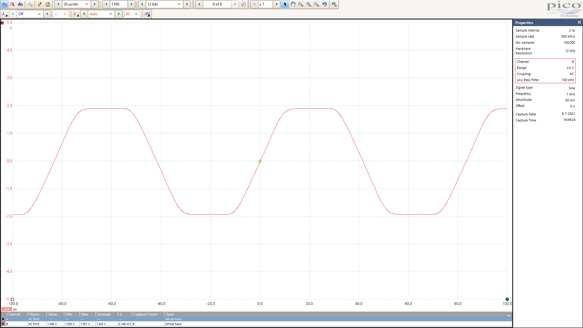

Hi DDAC,
I up-sampled your 12Khz/48Khz file with my PCM1792 to 192Khz, and the first image came out.

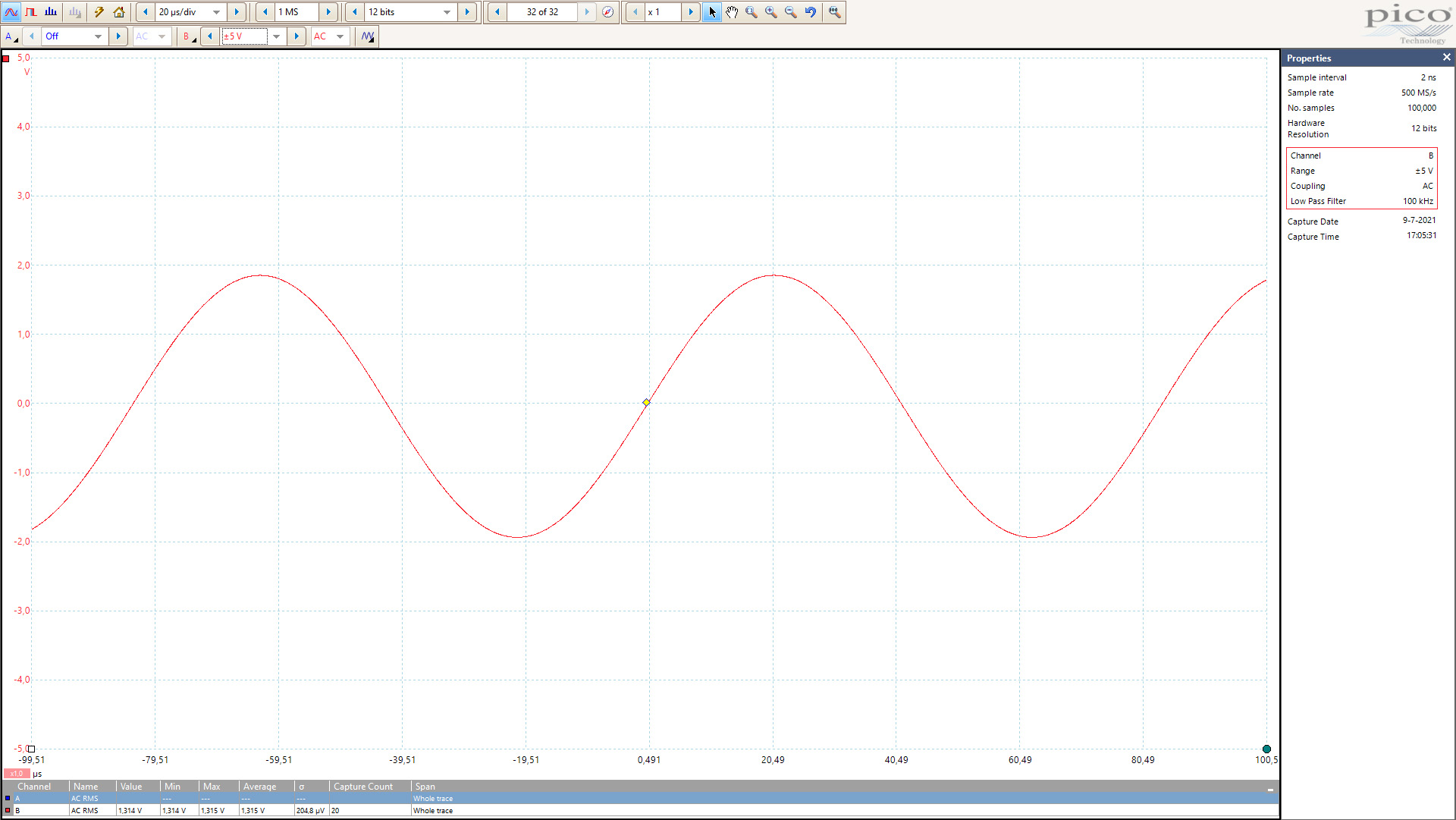

Then I instructed JRiver to up-sample to 192Khz, and the second image came out.
Very strange, but interesting to know.
I never liked JRiver doing the up-sampling.
Hans

The correct answer would be a sine wave: all odd harmonics of 12 kHz alias to 12 kHz, so you end up with 12 kHz as the only frequency component below Nyquist.
Do you get the same waveforms when you attenuate the signals before converting the sample rate? It could be an intersample overshoot issue.
True, but in this case it must have been an unfiltered square wave, because the PCM1792 could not have produced this trapezium like signal.
But JRiver obviously filtered everything above 24Khz, including the first harmonic, resulting in a sine wave.
Hans

Suppose you have a discrete-time signal with samples +1, +1, -1, -1, +1, +1, -1, -1 and so on. The only signal band-limited to the Nyquist frequency that can produce those sample values is a sine wave at fs/4 with amplitude sqrt(2) and phase pi/4 rad at the first sample. Hence, that's the correct reconstruction.
If the reconstruction or interpolation filter clips at +1 and -1, a part of the sine wave gets cut off, producing a kind of trapezium.
Marcel, the trapezium with the PCM1792 was caused by clipping.
When attenuating the signal by 3dB, it became a perfect sine wave.
Hans
