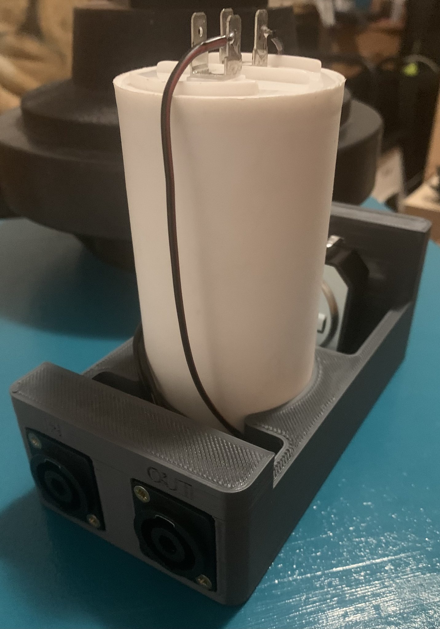

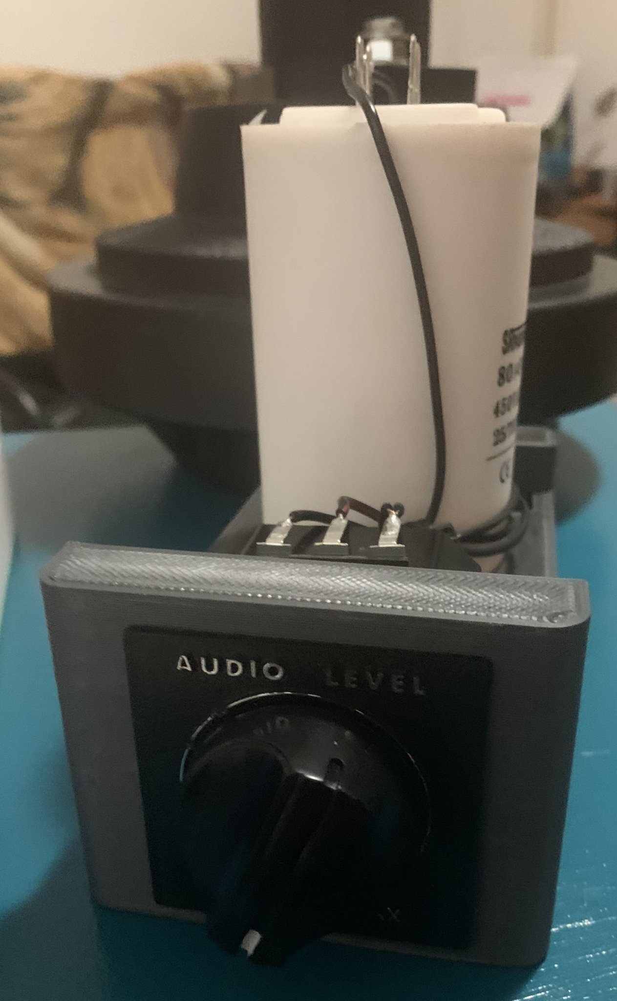

Extremely cautious measures taken🙂 80 uF cap and an L-pad. Unfortunately, I had 8 ohms only, so not that ideal. I will maybe try to add a resistor in parallel with the driver.
As we know, a fraction of a watt (95dB or less at a meter midband) would not have damaged the drivers.I am puzzled, what could have happened? Either I have destroyed them with the (relatively silent) sweeps or they must have been damaged before I bought them new in a factory sealed box.
If DC were the problem, you would have heard a loud "clack" sound both when you hooked the driver up and when it was disconnected.
It sounds like the drivers had been damaged (perhaps by a company doing destructive testing), reboxed, returned for repair, then accidentally shipped out as new.
Or gremlins did it..
At any rate, a capacitor and L-pad resistor in series (or a resistor in parallel) will change the response of a driver considerably in nearly every measurable aspect.
Yes, really strange. No real power went into the drivers under my control. And no other drivers got harmed using the same process/amp. This is just for the start when they get back. I will need to pad the driver sections anyway, this is just for the start.
