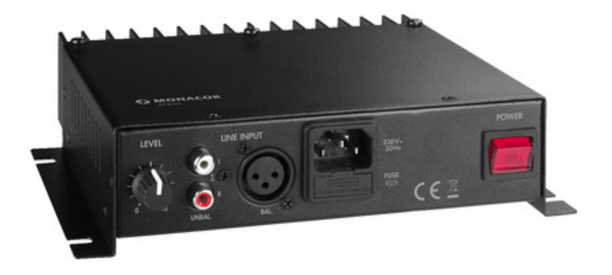

I use this amp:
https://www.monacor.de/produkte/akb-60/?r=pdf

I have a 3W class D battery powered amp to try out. I will use a protection cap and also an L-Pad since that is what will be connected with them anyway.
