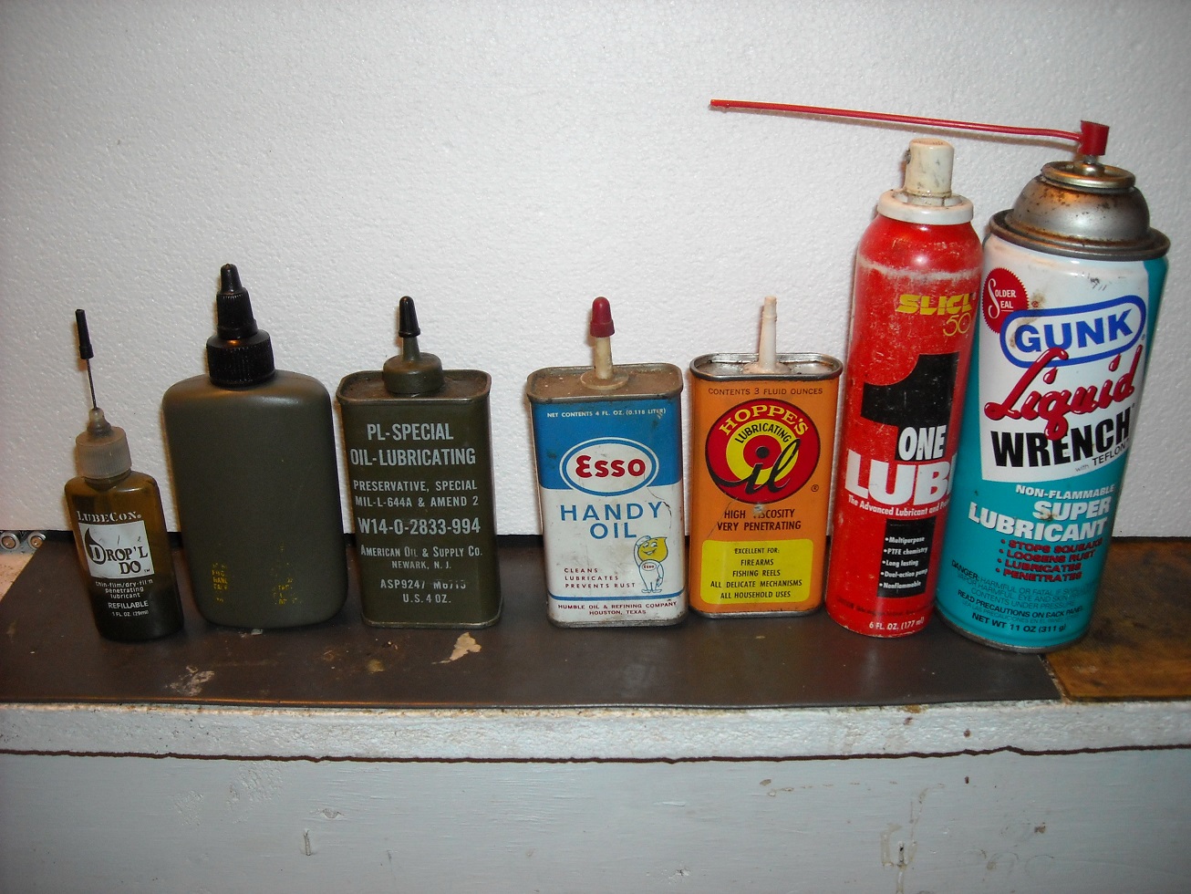

Back on the lubrication issue, I have these oils available.
The far left is a dry film lube.
The one with the yellow marking rubbed off is LSA weapons oil
The rest are pretty generic.

TheGimp, how old is that Esso branded oil?
For those who do not know Esso was the brand/company before Exxon.

No date on the bottle. I guess late 60s. It became Exxon in 1973 so it pre-dates that.
There was a red can and a blue can, but I can't find any info on which came first or when the color changed.
