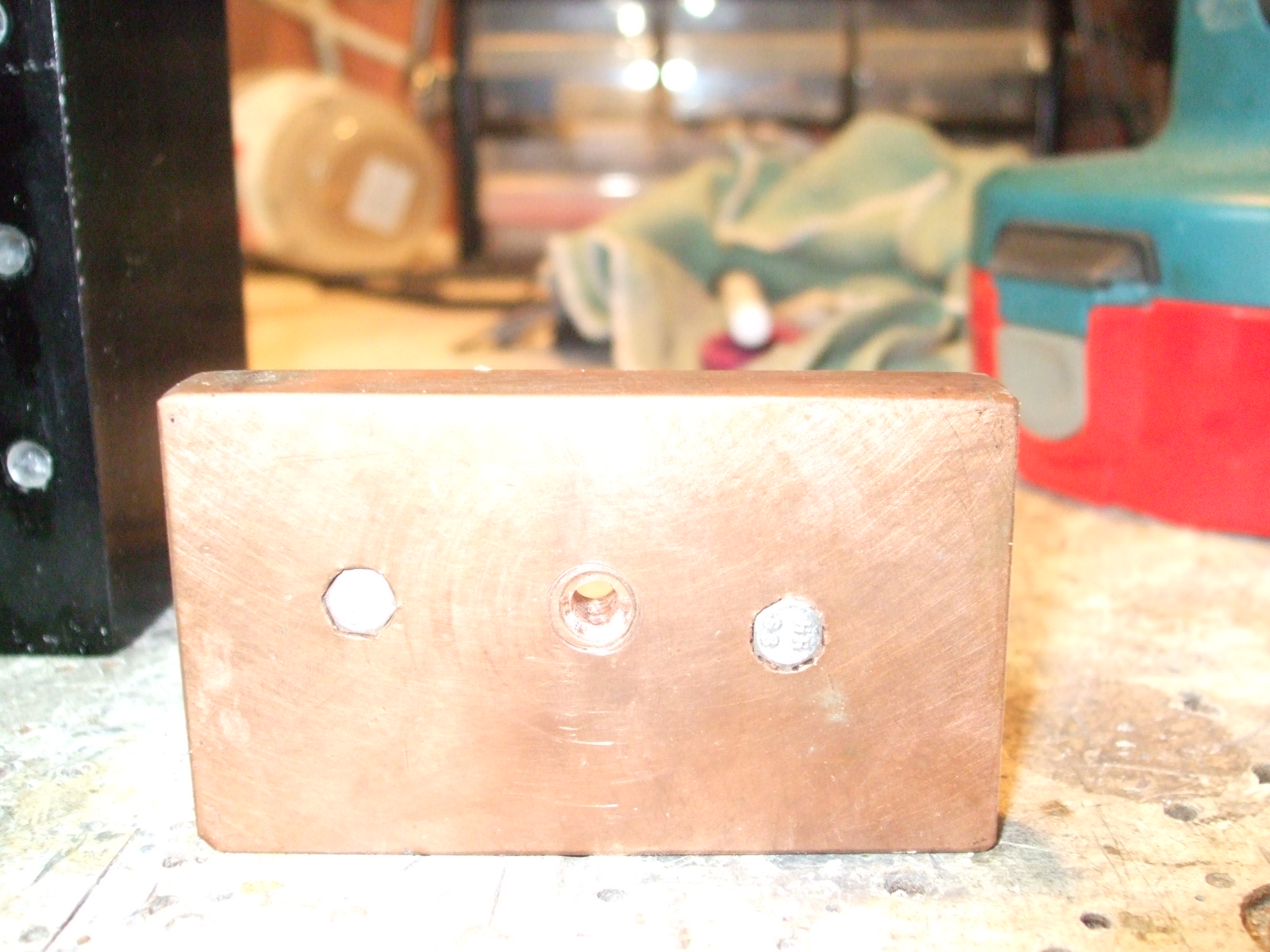

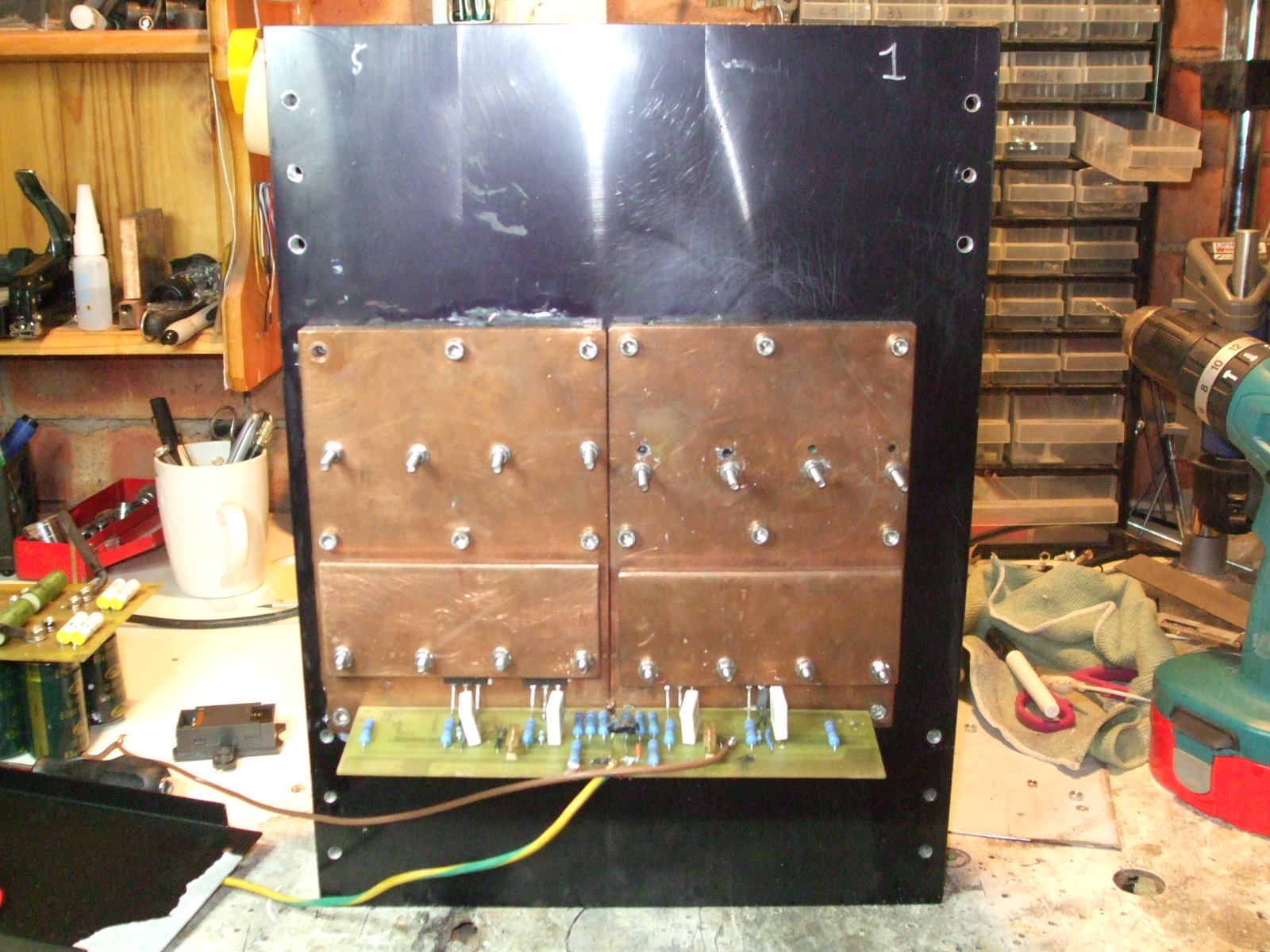

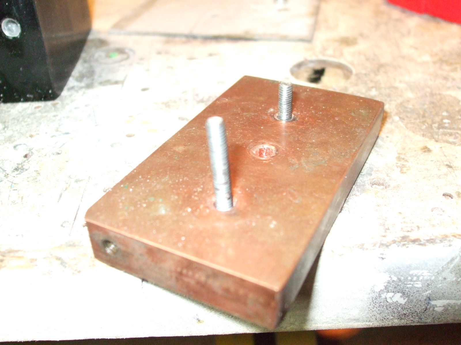

I had quite same fun (not) lapping a cooper heat spreader to the sinks firs with carbide then warnish scratch remover and Bi carb of soda to the point that once cleaned up and dried the copper would stick to the sinks and have to slide the 2 off 2 take them appart.

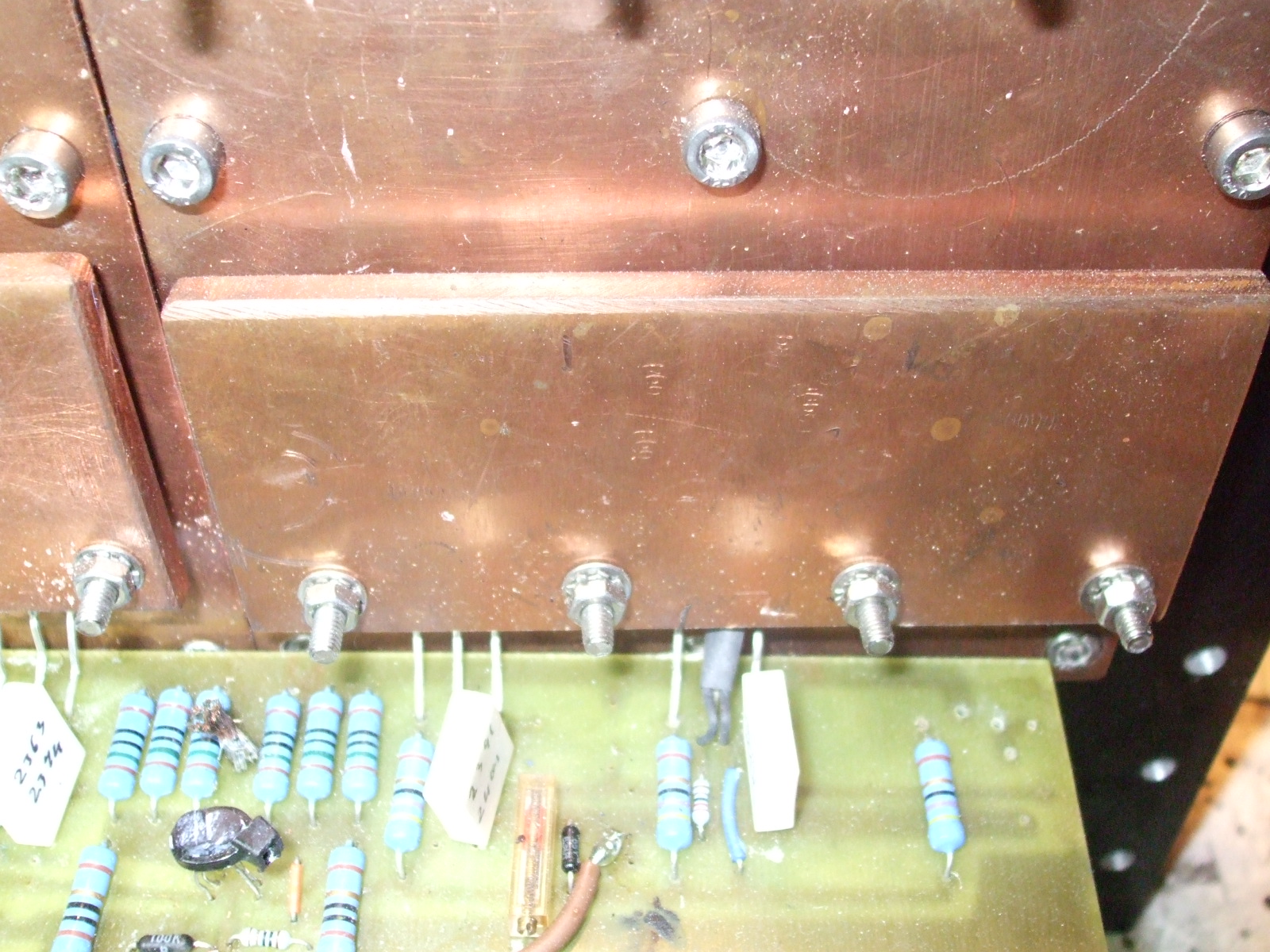

The 2 are now bolted togheter with graphite based heat transfer paste and kerafol red
83/86 under the 4 mosfets those are clamped on the heat spreader with a cooper bar
Much more pressure than the single standard screwwuld alowd.
Almost 200W on each sink and themperature setles at 42 to 46 C (depending on ambient)

Main thing is to forget about the single screw and clamp them real tight Kerafoll graphs show that the performance increase with the pressure.

Bias for the mosfets was at 1.5 A 48W so a total of 192 W dissipated by each of the sinks.

Overwiev of the heat sink and details (size is 300 X 400 X 83)
top set of screws for second board as byamping and possible balanced.
The earth block showing screw arrangment M4 at present M5 possible in a jffy(same on the heat sink)
This is as I do not like to strip the treads as loads of torque and repeat assembly
