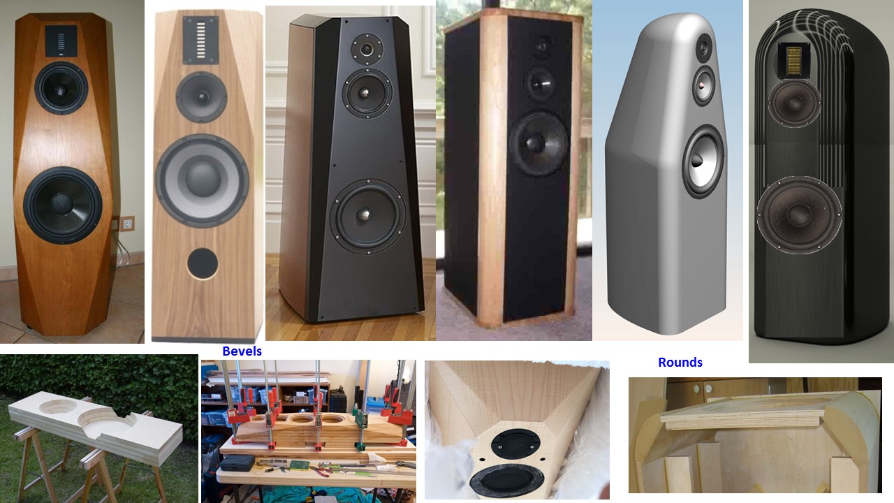

CONSIDER: Simple rectangular box with two horizontal shelf braces PLUS one vertical spine brace PLUS a deep cut baffle with either edge bevels or rounds to reduce diffraction. One shelf brace is part of the TM box, the second shelf brace near the woofer spreads the woofer vibration eneregy to all four sides.
BIG bevels or BIG rounds. What style do you favor, and what can you build?

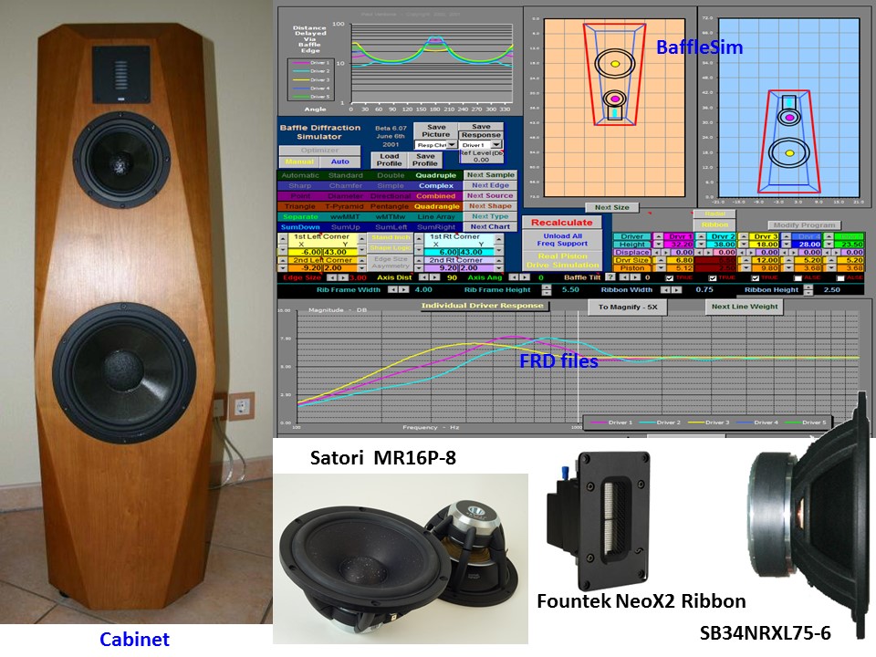

Single Cabinet ... Since your TM speakers only start at 300Hz, I do not think you will use them as "stand alone" monitors, and so a single 3-way cabinet where the woofer shares the total box volume to reduce the total size seems logical.
Simple Box with "deep cut" baffle for reduced diffraction ... Since you want to limit the baffle width to ~14" and since the sealed TM only requires 0.2cuft volume, there is not a compelling reason to build a cabinet with curved sides or a curved rear for a 300Hz woofer crossover. The cross bracing will help reduce resonances.
Vertical Baffle ... Since you are using an AMT tweeter with very modest vertical polar dispersion, a vertical baffle with the AMT at 36"-39" ear level seems logical. The crossover will manage the time alignment. No complex slant baffle is necessary.

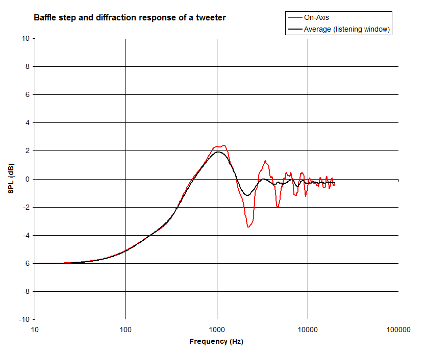

Offsetting the tweeter a bit to the side can look promising on a simulation board, but you get a similar effect once you move your listening position horizotally off-axis and if you did the same with an offset tweeter, the smoothening effect would have worsened by then. A chart I made in excel shows an average of 41 simulated curves from Response Modeler of a tweeter mounted on a baffle, centrally placed with sharp edges.
- on-axis
- horiz.right: 5,10,15,20,25 deg
- horiz.left: 5,10,15,20,25 deg
- vert.up: 5,10,15,20,25 deg
- vert.down: 5,10,15,20,25 deg
- right and up: 5-5, 10-10, 15-15, 20-20, 25-25 deg
- right and down: 5-5, 10-10, 15-15, 20-20, 25-25 deg
- left and up: 5-5, 10-10, 15-15, 20-20, 25-25 deg
- left and down: 5-5, 10-10, 15-15, 20-20, 25-25 deg

Given all the constraints, seems like Avalon cabinet style is best. Even if you have 12''woofer, the side chamfer hides its size pretty well and looks pretty nice not too but thrice. If you have fairly deep chamfer, it may actually have pretty nice diffraction signature. I don't personally like two-cabinet solution ... might end up having more work.
Or go four way with side woofer.
I agree the Avalon facets makes the cabinet appear smaller. But I just am not wild about the look.

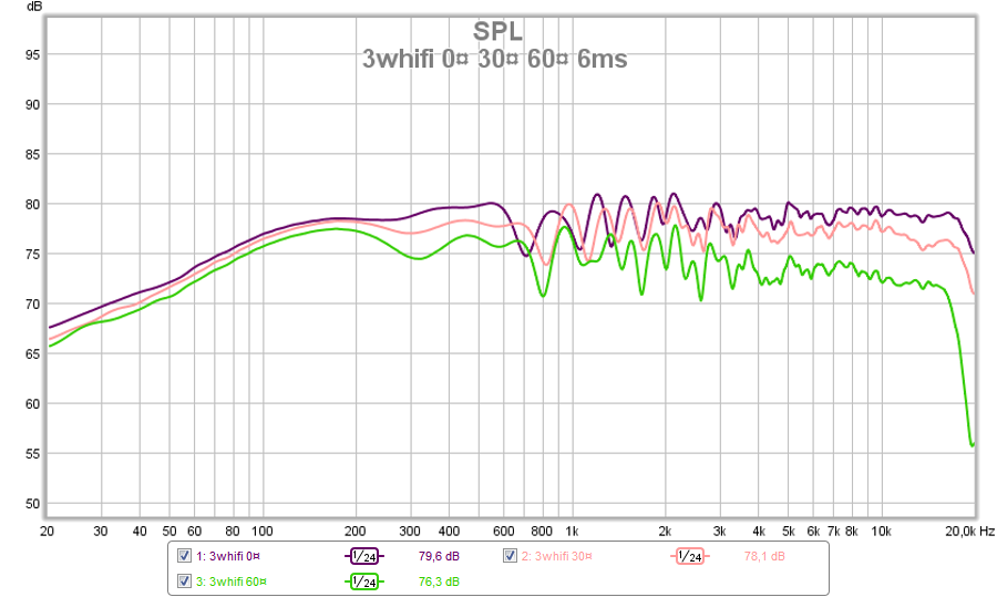

I have a similar Avalon style 3-way semiactive design going on. W-M vertical distance is not so critical as Linesource tells, in my opinion. Some lobing in the direction of first floor reflection is not a bad thing... There is some ideal height for W, but it depends on planned listening distance and xo frequency.
It would be ideal to set W very low to raise it's floor bounce null F above passband and mid high enough to lower it's bounce null below xo. Then in xo-range beam lobing would minimize floor bounce nulling effect!
My WM xo is supposed to be around 400Hz LR2 done with minidsp 2x4HD. MT xo will be passive around 4kHz and I am struggling with that now...
W SBA 29NRX-6 (single, closed box)
M Audax HM100Z0 (closed)
T Fountek Neo 3.5H (perhaps without the horn but in a carved-in waveguide)
I have never done 2-ch measurements, don't even have gadgets, so very much trial-measure-correct.... Too easy to do with dsp...

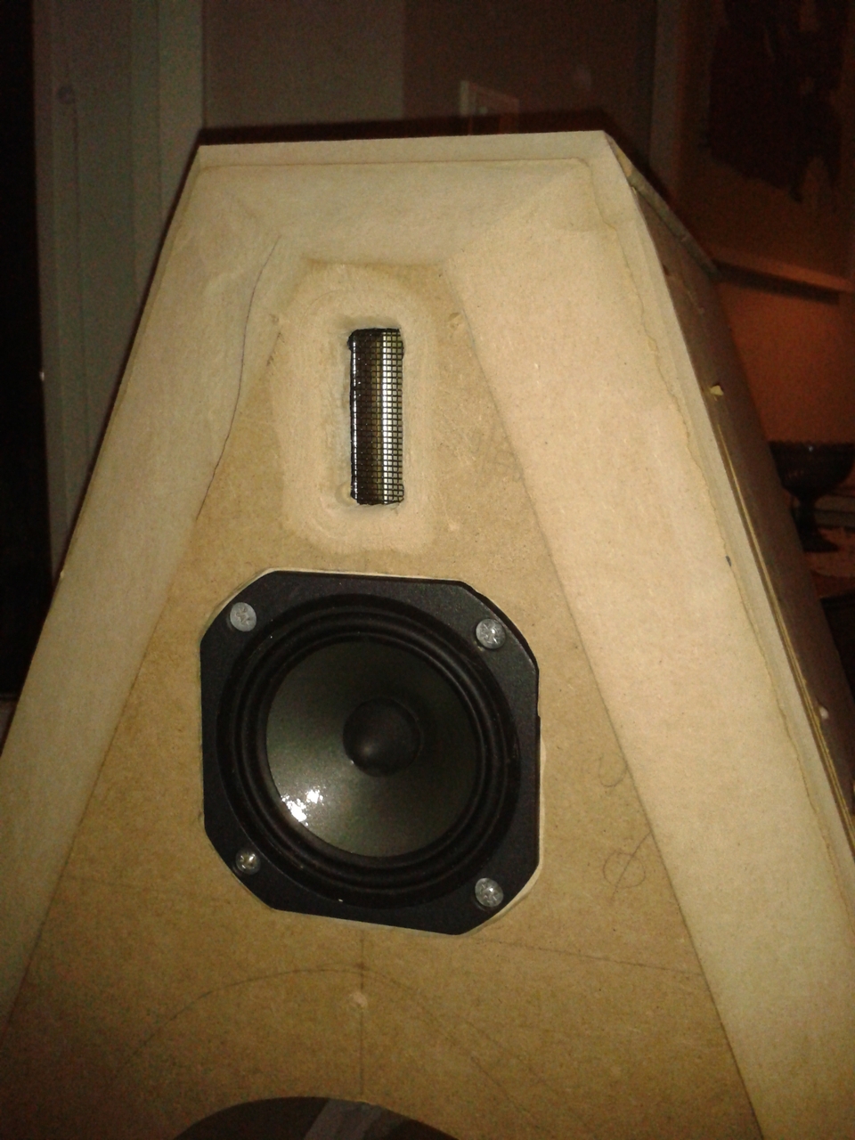

Here is a photo of my first proto of it 3 year ago and the MT test baffle with M up. Proto had double 8" bass drivers.
Actually I don't like those diffraction wiggles between 1-3kHz at all! My ideal baffle is wide curved like Sonus Stradivari! But that is more difficult to "hide" in a room. Perhaps i will try Magico Q style moderate width curved baffle next!
Ah hah !!! My original post's question is answered in posts #28 and 29.
When I asked how a person determines baffle shape, size, etc ... what I didn't know is there IS a modeling program for what different baffle designs will do.
Told you I'm new to this, lol. THAT is what I was originally asking. HOW a person can know what to expect from different baffle designs.
So the above program allows you to move the drivers around on a simulated baffle, and it will show you the expected effect on the Freq response?
There are actually 3 main diffraction programs available for free download:
1- Baffle Diffraction Simulator - which is what LineSource has been using. Of the 3, it has the steepest learning curve. Requires Excel.
2 - Baffle Diffraction and Boundary Simulator - probably the most widely used with the additional benefit of including boundary effects. Also requires Excel.
3 - The Edge - simplest and easiest to use but strangely, doesn't include the effects of chamfering or rounding the edges.
Programs exist for more that just diffraction as well. Check out Jeff Bagby's full software suite here: Jeff Bagby's Software Page
