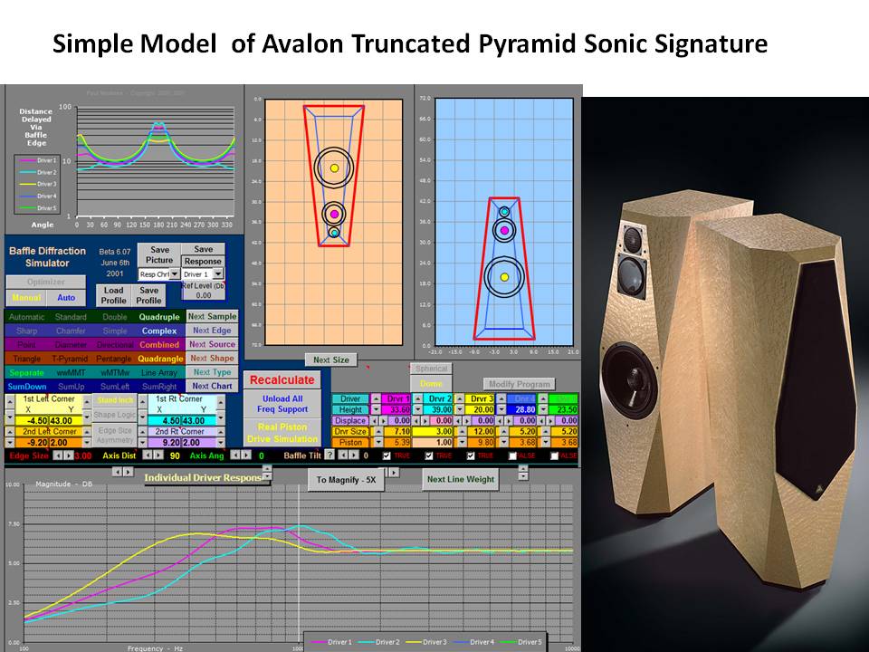

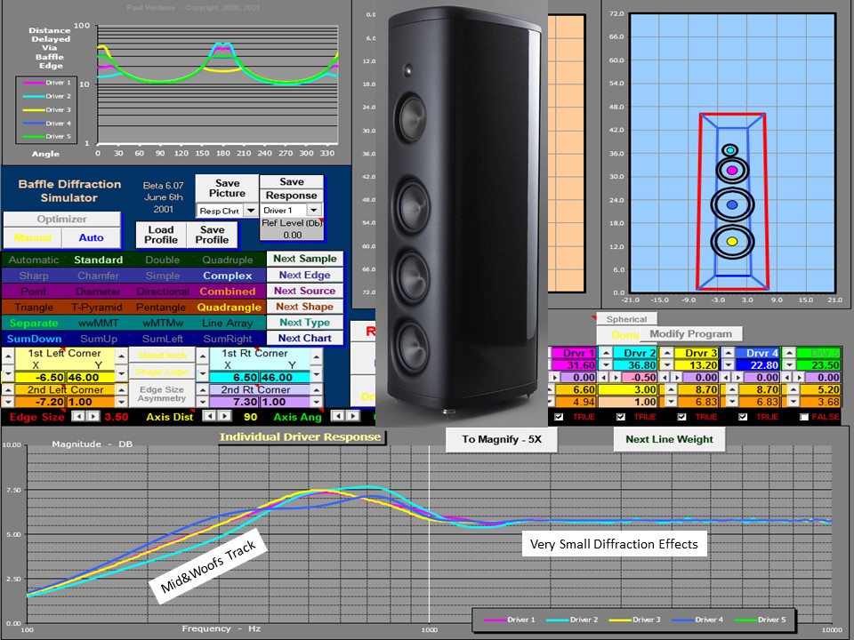

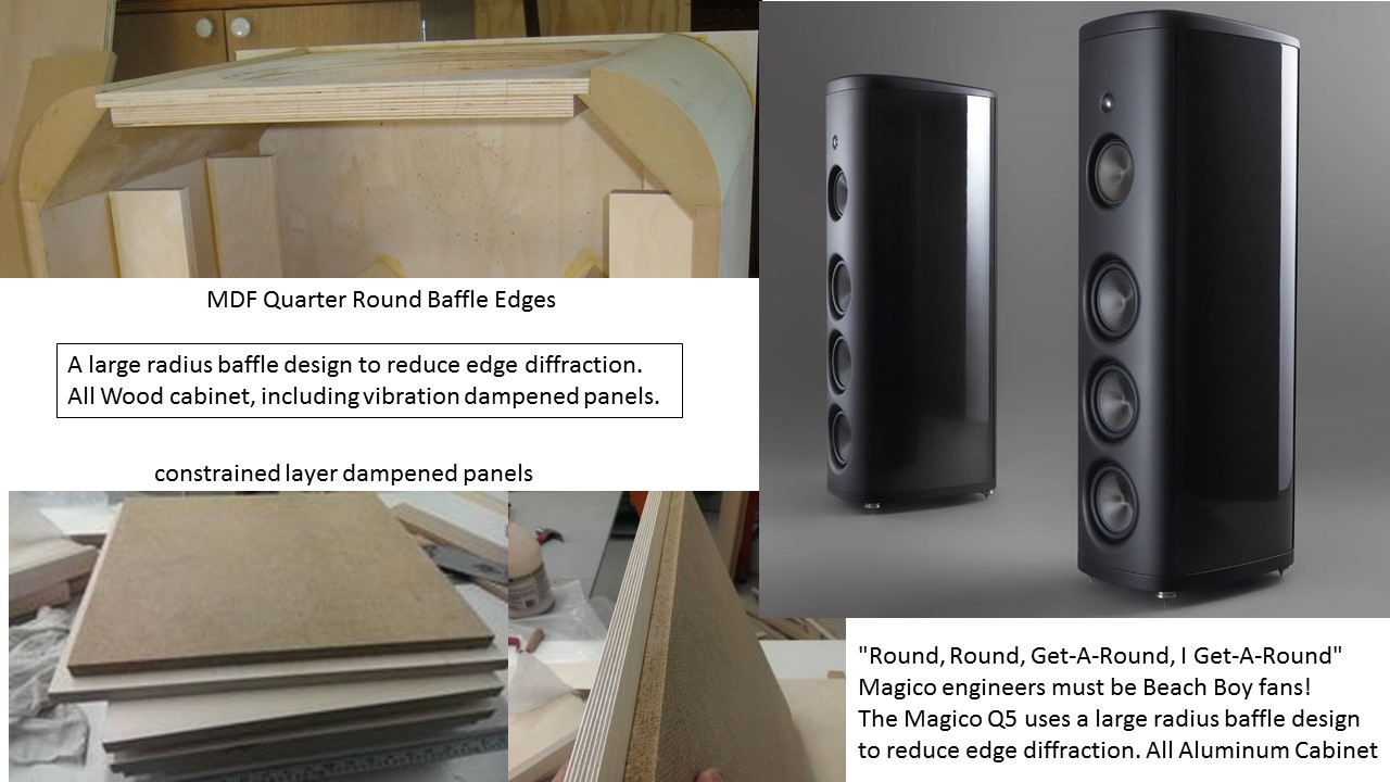

Baffle diffraction simulations show that large rounds on all front baffle edges, plus careful driver placement, will significantly smooth the SPL response, and also simplify the crossover circuit(function).
Bevels which create a truncated pyramid baffle like Avalon speakers significantly reduce edge diffraction but still add some "dither" to the in-room SPL response. Does a little dither trigger the imagination?

Go with the HUGE Round-over! You cannot go wrong!
