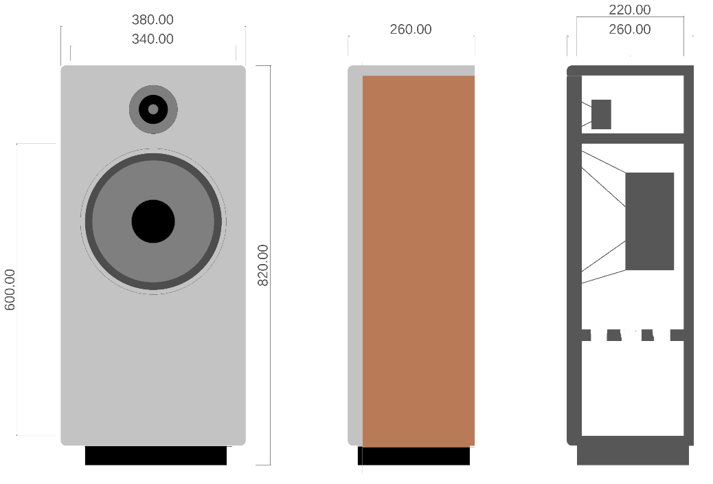

Here's a quick sketch. Front and top made of 30mm colored mdf, the rest of the box of 18mm plywood. Volume should be around 45l, so it's a bit undersized from the suggested 50l.
The top sub section for the tweeter helps as brace as well as another brace with holes.

No good reason I'm afraid, you're right. I just got stuck with that value in the simulator at one point and rolled with it (a good sign I'm tired and should go to sleep). Yes that brace could be opened too. Without definitive T/S values, I'll have to tweak the Linkwitz transform by ear/mic anyway.

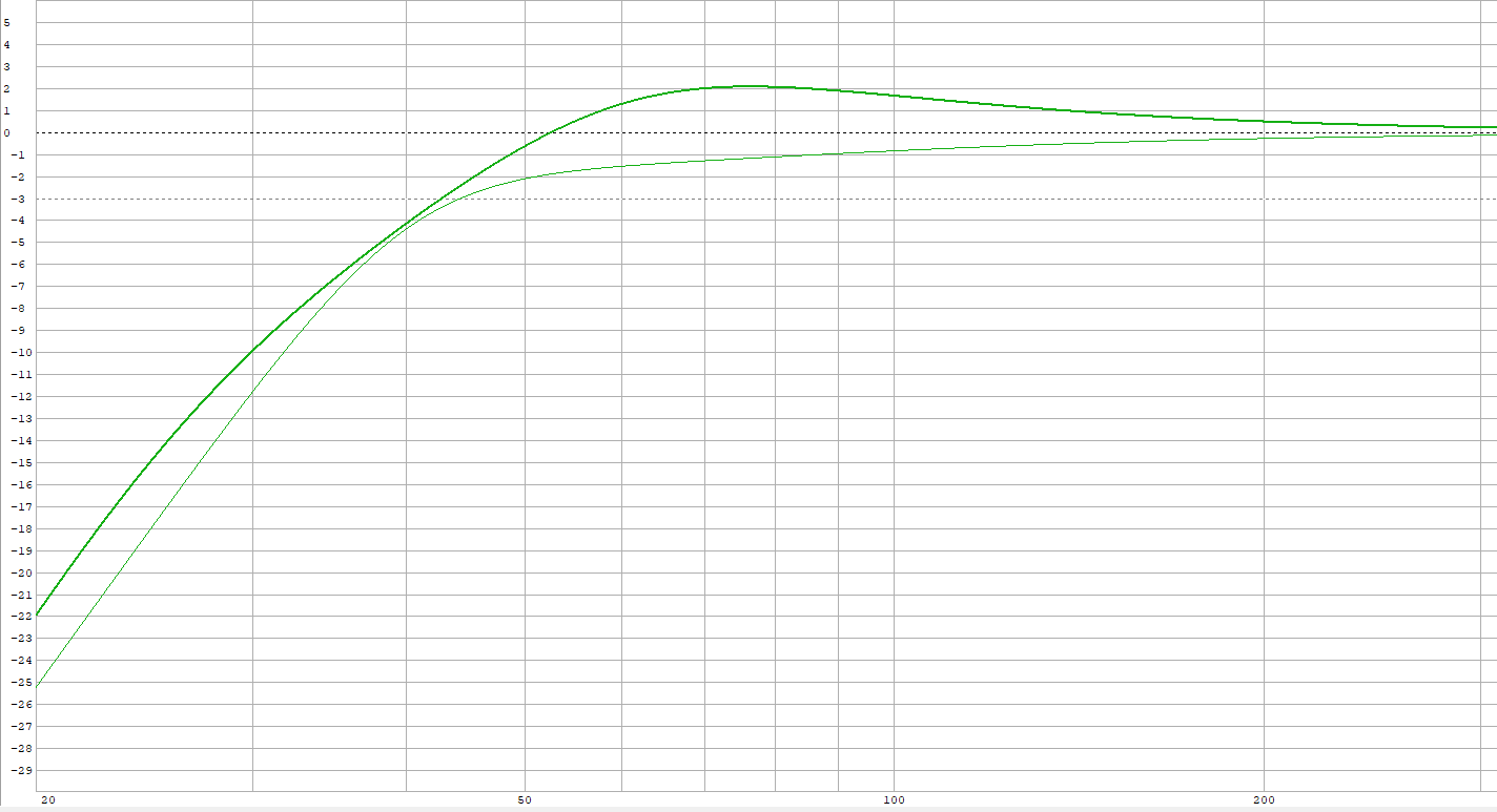

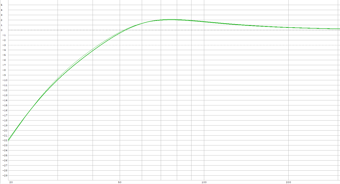

If I apply GM's suggestions (thanks btw !), I arrive at about a 140L enclosure, tuned at about 40Hz (the drivers aren't very different wrt Vas and Fs). But as the other parameters are quite different, the frequency responses are quite different (see first picture, thick line is driver 2, for 10W).
Fooling around with resistors in line with the drivers, I get a much better match with no resistor on driver 2 and a 5R one on driver 1. But it's hard not to get a peaky response with a BR enclosure and these. The option of going sealed with a LT isn't very elegant but I could tailor the LT to the drivers parameters to achieve a similar response.

I'm going to let those drivers play a bit, see if the parameters change as they might not have been used for a while.
You're welcome!
'Sounds' like a plan and if they don't get to a typical factory's < +/- 10 %, then average the specs to design with, which normally sounds better than one might think due to being a stereo system in a typically acoustically 'messy' room and summed internally by the world's most powerful processor known to mankind.
