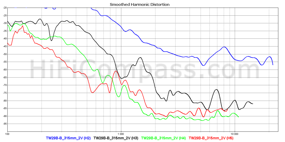

Why 6dB at all? The power for the tweeter on low frequencies drops not nearly fast enough. It is likely it exceeds its linear excursion (not built for that), underhung drivers (like tweeters) often practically explode in distortion if they leave the linear excursion (but are often excellent before that).
Do a gated measurement, measure K2, K3 and K5, ~50cm-1m, away from the walls. Tweeter first, if that's not conclusive, then measure the mid driver.
What measurement mic do you have? Do you have a compensation file for it?

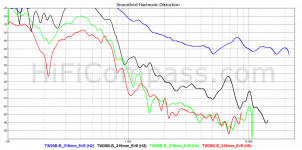

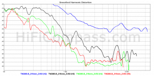

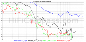

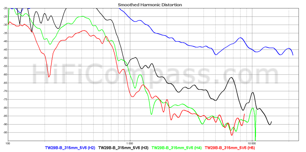

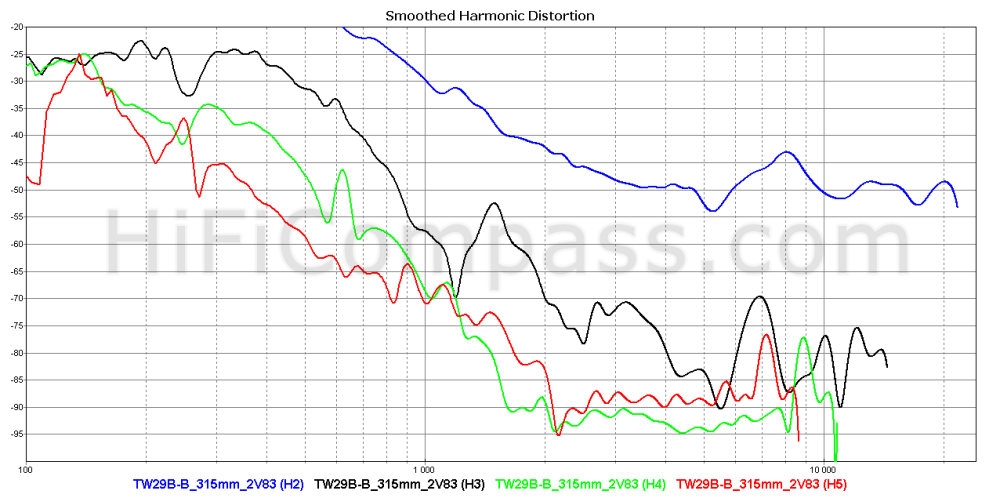

Satori TW29B | HiFiCompass - всё для акустических систем и не только

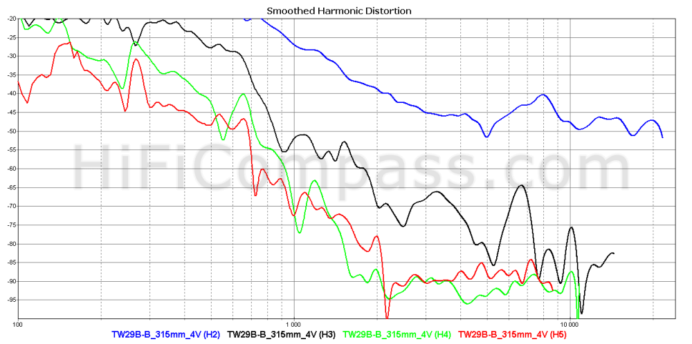

The distortion very quickly rises with the spl below 2k.

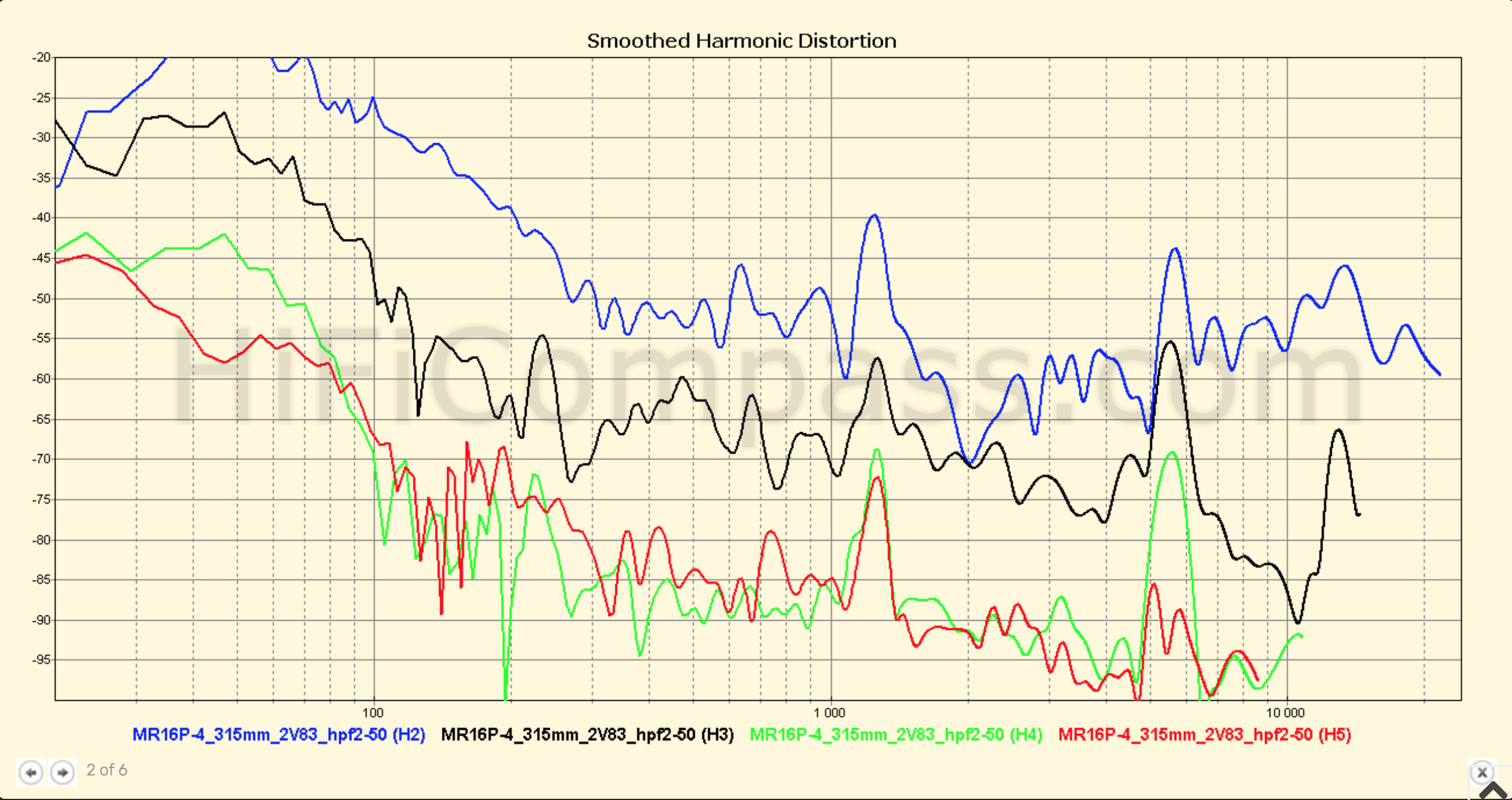

Well yeah I've taken a deeper look in measurements of the tweeter and midrange and I noticed that actually the midrange already has quite rolled off at 3 kHz. To really keep a consistent off-axis response it would be actually beneficial to cross at 2 kHz, though what will that do to the sound signature? Because of the more consistent dispersion the tweeter and midrange will blend in better and there might even be a slight improvement in soundstage, though I'll only get the Sd and richness of the MR16P-4 to a lower frequency, do you think it will negatively affect the body/richness of the sound by much or won't it be a problem and does that more depend on the frequency response. Second problem, judging on the distortion graphs, the TW29B really doesn't like to play under 2 kHz which will be a problem, also with a second order filter. The TW29BN doesn't rise in distortion nearly as much. It also has a 3 dB higher sensitivity which will greatly reduce distortion again. Substituting the TW29B for the TW29BN will be a good option. I don't have it though BUT, my project is sponsored by SB-Acoustics/Frank Nielsen themselves/himself, I got the drivers from them in the first place. Maybe, if I explain my problems to them, they might send me a pair of TW29BNs. I'm not sure and this is just a speculation but it's worth trying.
Also I noticed the MR16P-4 has the same problem as the tweeter, judging from its distortion graphs it doesn't like to play under 300 Hz either so I think the crossover between the midrange and woofers should be 2nd-order as well.
So ideally what I'm gonna do now: swap the TW29Bs for TW29BNs, if it doesn't negatively affect the tonality of the system too much take the midrange-to-tweeter crossover from 3 to 2~2,4 kHz, make the crossover slopes a higher order (so probably 2nd-order filter in the DSP) and EQ the speakers flat but anechoically so they have rolled off in-room response.
I think this should greatly improve the systems performance. Gonna write an email to my man Frank now.
These are the compromises you'll have to decide for yourself. Perfection in every and any characteristics is not possible. You will not get a 'rich' sound, if the distortion is too high, that harms the sound quality by far the most. The choice of the mid driver is not a logical one, it's too big. If you want more 'richness', why not let the bass drivers go halve an octave higher and use a smaller driver there? That will give the lower mids even more 'grunt'. You could also do a 2,5 way, the one coil is something the speaker can take without sacrificing anything if you don't have 2 spare dsp channels. Besides that, a 5" driver is perfectly capable of 300Hz with enough 'authority', it doesn't even start to sweat at party levels.
Congratulations on the sponsorship. The spl isn't of any significance for a tweeter if you are using a dsp. The problem is not the driver, it's the crossover setup, you need to use a different filter! If you swap the tweeter, the problem is only dragged away for another foot long, not all across the street.
That's completely nonsense! The MR16P-4 does not have a problem with 300 or 200Hz. It can go much, MUCH lower than 300Hz, it got a Xmax of 3,1mm, that's midwoofer territory! It got a very low Qts of 0,25 and therefore the measurement OFCOURSE drops sooner. That does not mean it can't go lower. Give it an appropriate enclosure volume of 5-7l and the f3 is at 90Hz at an ideal Qt of ~0,7.

Well, you can say upgrading the tweeter isn't necessary which I believe you it is when I thing right. BUT I GOT IT! Frank is happily willing to send me a pair of TW29BN-Bs! Okay it might not be necessary but hey, be honest, the TW29BN-B DOES HELP. And even if it's lower distortion isn't relevant, the stronger and more compact magnetic field of a neodymium motor is always beneficial, also for transience and overall performance.
I understand the MR16P-4 is capable of way lower frequencies in terms of frequency response, but its distortion starts rising linearly below 300 Hz.
Well, if you don't use it below 300Hz, then there's no argument left to use the driver, why not change it to one of the 5"? 5" is plenty of cone surface for 300Hz. And they all do the 3k happily. Problem solved.

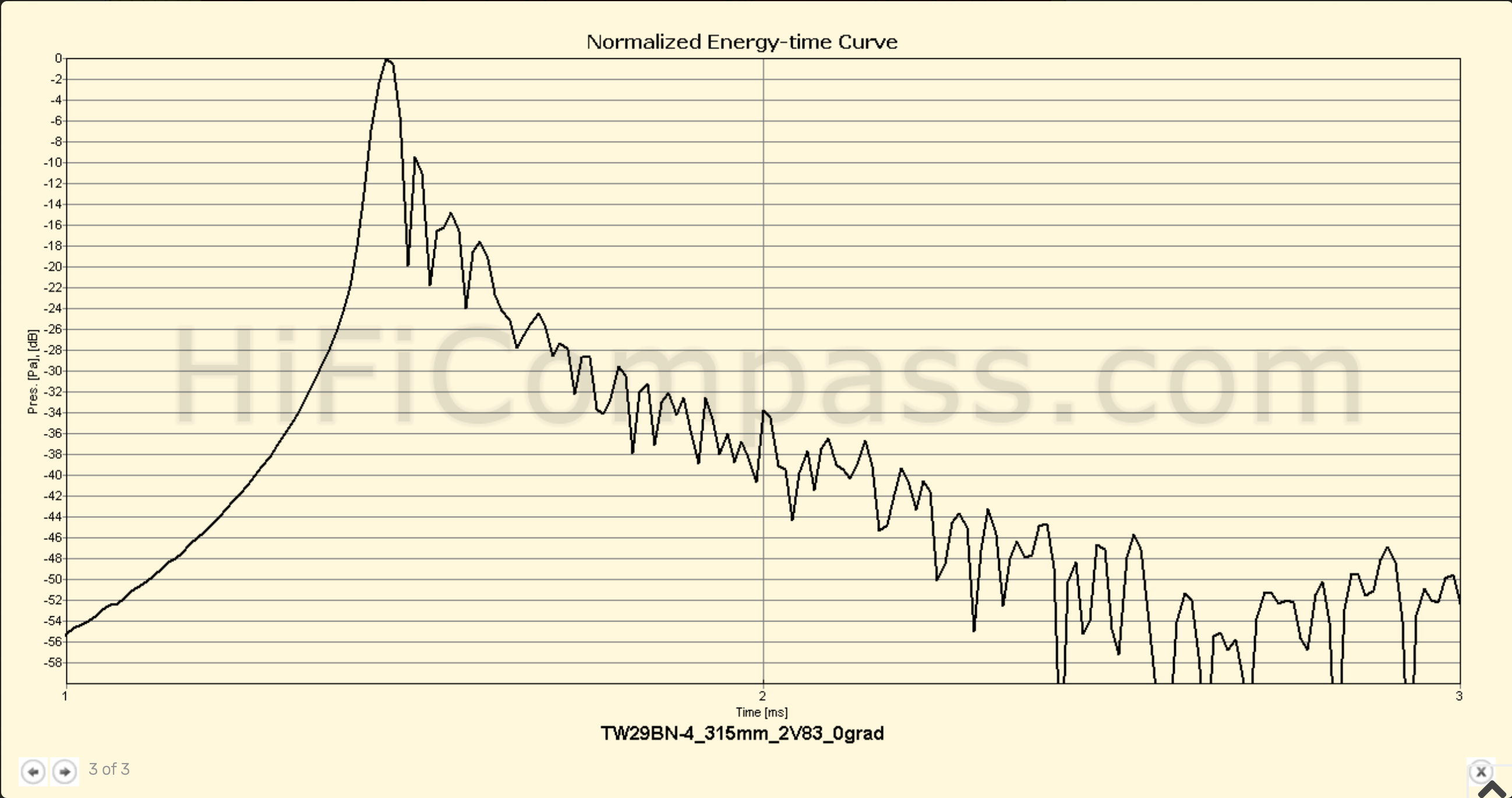

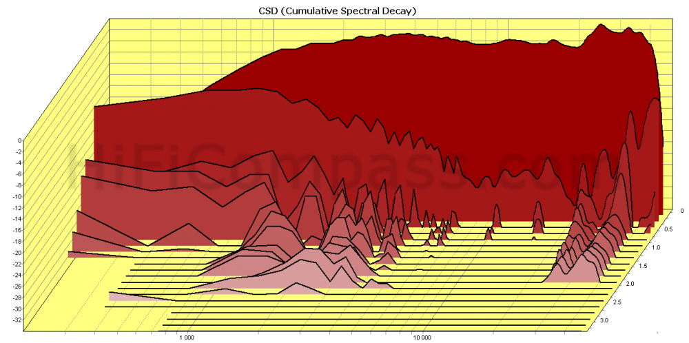

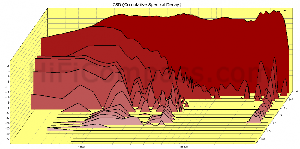

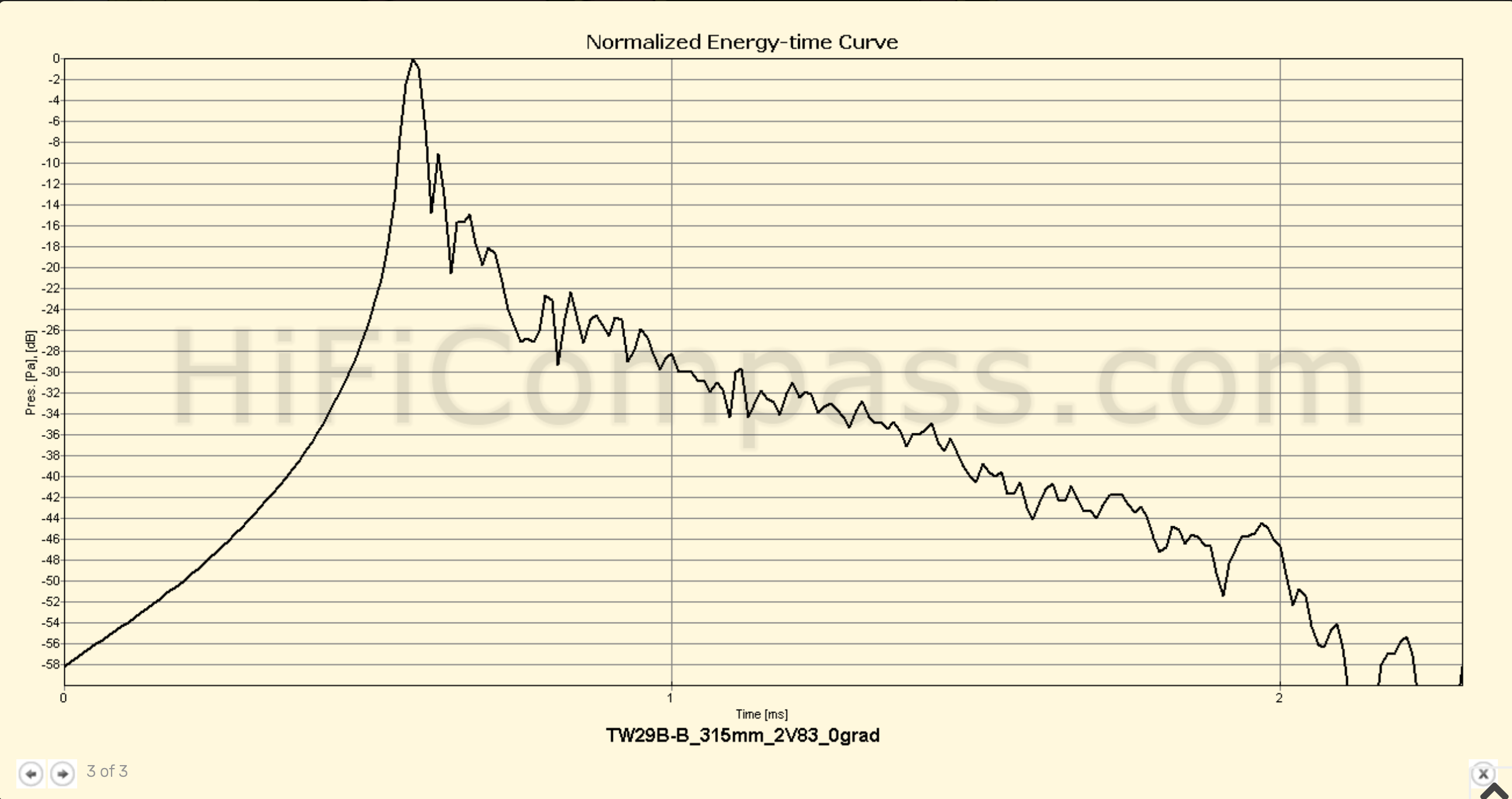

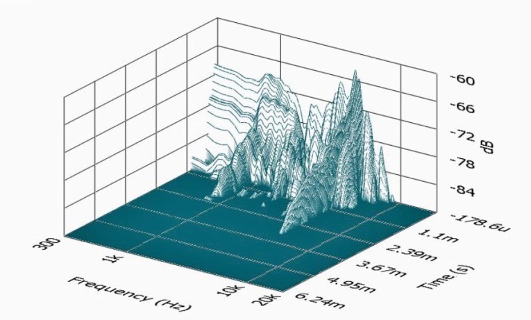

Hmm, that decay is quite a thing. The TW29BN does have quite a lot more decay there. The decay of the TW29BN-B is actually quite bad compared to the comparable Scan-Speak Illuminator beryllium tweeters. The distortion I can work my way around in the crossover but so maybe then actually the TW29B will be the better option after all.
The energy storage in the TW29BN isn't as good as well. In case of the TW29B the curve really drops off to practically nothing after ~1,5 ms. In case of the TW29BN the curve rolls of until it kind of stays flat and extends to beyond the end of the graph.
