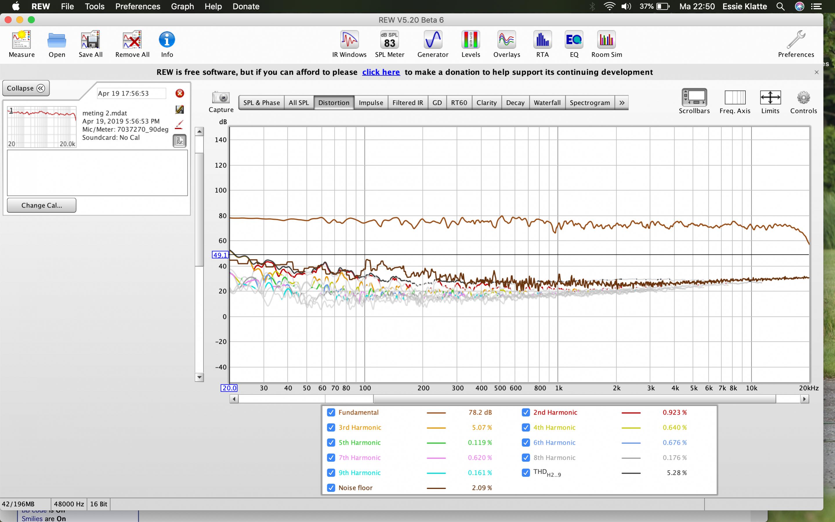

What is the average THD within a specified frequency band, and at what drive level? Just curious.🙂
That of the tweeter or the entire system?
For the tweeter itself. It's at it highest at 1,1 kHz at 1,8 % gradually going down without any peaks to under 0,2 % from 5,5 to 8 kHz and then gradually rising to 1 % at 10 kHz and then slightly lowering again to 0,8 % at 20 kHz.
This is at 94 dB.
For the entire system, this was the last in-room measurement I made at 75 dB. I don't know if it's any accurate or reliable though.
This is at 94 dB.
