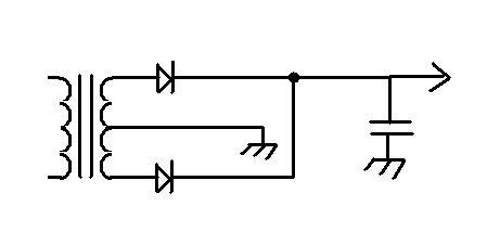

How about this full wave cct.
Review the pdf on catalog page 11 (page 13 pdf pages)
Try it, you might like it.
