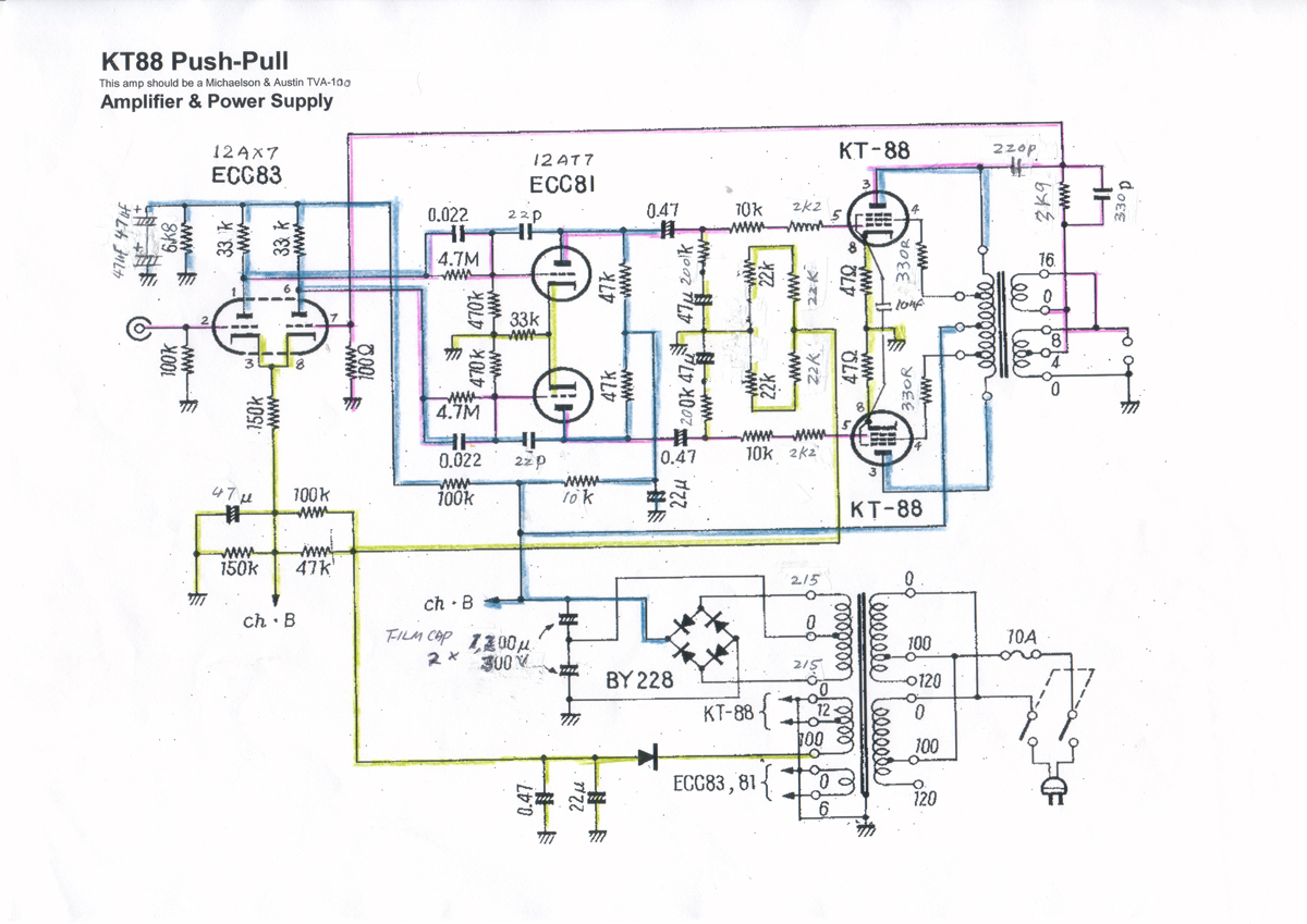

I don't have the schematic of the TVA-100. The attached circuitry is the trace from the TVA-100 based on the schematic of the TVA-1. The circuit maybe not complete but the parts values are the TVA-100.
Arron

Hi Arron,
Thanks for your reply.
First of all - it's a heavy modification on the TVA-100 if my eyes don't cheat on me.
It seems as if the four pots for the negative bias has been removed. I you look at the schematic drawing of yours, if believe that the bias circuit can't work this way.
The approx - 150 Vdc goes through the two 22k resistors and to ground. I my opinion the minus voltage should go to the negative pole of the 47uF capasitor and then through the 200K resistor to the 2K2 grid stop resistor. Just to have approx -55 to -65Vdc for the KT88 grids?
Working with the TVA-1 nr. 553 I have experienced from a good friend of mine, that the bias circuit should be changed from the 200K on your schematic to 100K and that the pot should be 20K with a 39K to ground. Still keeping the 47uF after the pots.
The reason is that only the old MOV KT88 (GEC) could handle the approx 340K messured from the grid to ground without running with the bias. All the KT88 reissues requires that the approx messured resistance from grid to ground don't exceed approx 150K.
Perhaps this is the explanation why several TVA-1 amplifiers some times went up in flames by use of KT88 reissues. The quality of todays KT88's simply can't match the original MOV KT88.
Tim De Paravicini's TVA-1 was designed and based on MOV KT88.
TVA-1 = Tim's Valve Amp no. 1 (according Mr. Colin, UK distributor)
Please find a small part about the TVA-1 no. 553 on:
leakstereo20
I think that you may have to redraw the schematic of your beautiful TVA-100 amplifier. The sound of these Partridge outputtransformers is quite unike IMO.
Please write back if I have got somthing wrong.
Best rgds
Kim

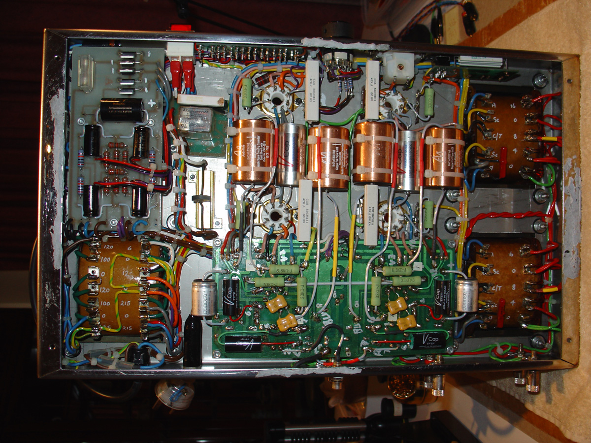

Out from the attached TVA-100 bottom picture from you, I quite understand that it is difficult to make an exact schematic drawing.

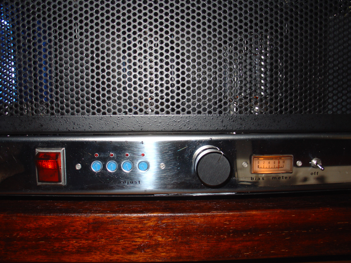

The TVA-100 has an external valve bias controls that can be adjusted each individual valve to achieve optimum performance. The picture shows the correct bias when bias meter reaches above 7 and the LED of the selected valve is light up fully.
Arron

Hi Arron,
Oh - thats a nice picture of your TVA-100.
This feature with the four front pots, switch and voltmeter makes it easy to adjust the bias for each OP-valve.
When I looked the first time inside my TVA-1 and saw the "birdsnest" of wires and odd components never used by M&A, I thought - what is it I have bought?
But after a while and a studio of the bias and driverboard I began to make a drawing of the amplifier - component by component. ( got some start help from another entusiast here.)
