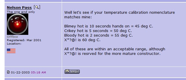

What NP said in 2003. Seems your taste matched with the more mature builders. :)

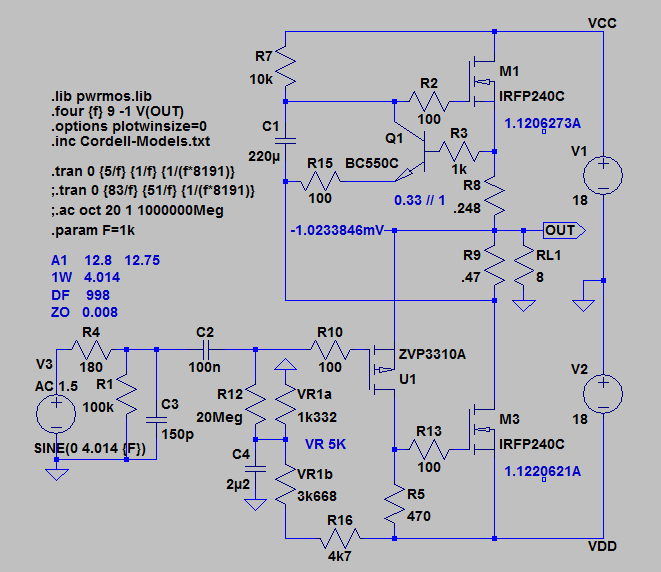

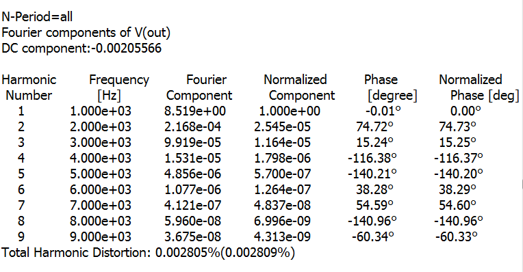

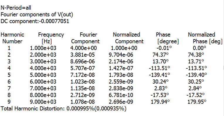

It is difficult to say anything of an amp when measured performance is not available. What do you guys think of this 10W Class A follower, 9.95 ppm @ 1W? I would not be surprised if it turns out to sound grainy on top regardless.
Many trained listeners perceive distortion as distortion or an unnatural thing whether it is high order or low order.
That can be not a distortion measured with resistive load. Effect of "slow amp" could be due to interaction with speaker as a complicated load.
